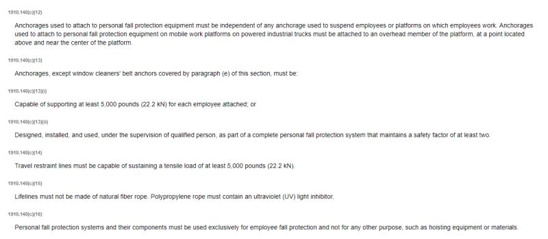

5000# Fall protection load
5000# Fall protection load
5000# Fall protection load
Does anybody knows where is OSHA says 5000# applied in all directions?
Can you please attach the document
RE: 5000# Fall protection load
It is kinda derived from the minimum tensile requirements for lynyards (5000 lbs). Check this link.
Link
RE: 5000# Fall protection load
1910.140
RE: 5000# Fall protection load
jayrod12 (Structural) thank you so much
It was so small cant read.
can you please attach it
thanks
RE: 5000# Fall protection load
jayrod12 (Structural),
may I ask where does it say 5000 in all directions?
RE: 5000# Fall protection load
Quote:
may I ask where does it say 5000 in all directions?
It doesn't. (At least the way I read it.) At one point, it does say that "Travel restraint lines must be capable of sustaining a tensile load of at least 5,000 lbs (22.2 kN)." [1910.140(c)(14)] But that's just for the cable.
I've always checked this requirement for all directions. The odds that a fall would all be completely vertical (in terms of reaction force) are pretty much zilch.
You'd also have to consider a person hanging there after a fall. He will not swing at all? (Ergo developing non-vertical reactions.) No way.
RE: 5000# Fall protection load
SrtP88- CFR's are available online, also, the latest OSHA rules are directly accessible from the OSHA website once you know the section number. Note that the requirement to have fall protection, and the required details for that fall protection, are in different sections.
RE: 5000# Fall protection load
You have to understand that the 5000lb force could act in all direction in many cases. Many anchors service 2 sides of a building. Some swing stage set-up may use anchors from a different area of the building that is blocked and tackled to suit their needs. The one I disagree with the most is straight upwards for a roof mounted anchor.
RE: 5000# Fall protection load
I can think of, and have seen a few situations where a fall arrest load could be applied vertically (or some vertical component):
1. Like jayrod12 said about anchors servicing both sides of a building, but sometimes there's a penthouse in the way and the lines have to go up and over.
2. Large architectural panels at the roof - essentially a 10'-15' parapet. Ridiculous, I know. Again, lines have to go up and over.
3. Accessing windows in terraced buildings can be difficult sometimes. The anchors are often hidden in the floor of a unit's patio and require lines to go over the guardrails. This causes other issues because the guardrails are often not structurally capable of deflecting the lines, and some buildings specifically restrict this.
But for a typical roof anchor - round HSS with a d-ring on top and 4 bolts to the structure below - I think the horizontal load case is probably the most severe. For example, assume the anchor has an effective height of 14" and the anchors are on an 8" square spacing - in the horizontal case, the bolt tension would be approximately 1/2x5000x14/8 = 4375 lbs and under the vertical case the bolt tension would be 1/4x5000 = 1250 lbs. I suspect a typical supporting structure would be stronger in the vertical case as well.
The direction requirement becomes especially tricky in trolley and monorail systems. All systems can tolerate being loaded with some horizontal component, but hard to put a number on the maximum angle out of plumb. And due to poor planning for future access in some buildings, many workers end up doing things like hanging 30deg out of plumb on a trolley or putting safety/suspension lines over questionable rails. I don't condone that, and I'm not saying that its right, but it happens and I don't think you can put 100% of the blame on the end user.
