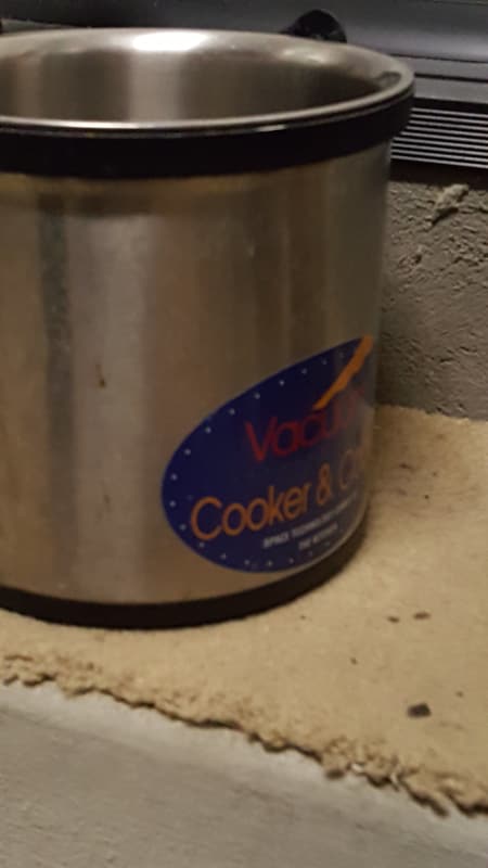

I don't doubt that. A vacuum insulated thermal cooker can be purchased for well less than $100: http://www.ebay.com/bhp/thermal-cooker?_trksid=p20...
And they provide about 6 hours of useful cooking time.

Thanks but that's not exactly what I'm doing. And vacuum insulation is too fragile to meet the needs of my target audience. Even in a heavy sleeve it's too vulnerable to shock.

"Even in a heavy sleeve it's too vulnerable to shock."
And what do you think will happen your aerogel?
Nevertheless, I not sure why you think a stainless steel vacuum vessel is fragile.

Ok, I'll admit it, I'm old enough to have broken a lot of aluminized-glass lunchbox thermos bottles in grade school. Stainless would probably be durable enough, though thermal resistance will go way down if it's dented to the point the inner and outer walls touch, and that would create a safety problem. As for the areogel durability, solid pieces would not be at all durable but the blanket material looks like it would be, the areogel beads are small and floating in a fiber matrix. The manufacturer doesn't publish a shock rating though.
I think I ran the numbers for radiant heat transfer across a simple vacuum annulus and it was worse than what I needed. But I'll run it again, the people who make those could easily make what I need. Getting a modified sample might be expensive but product development usually is.

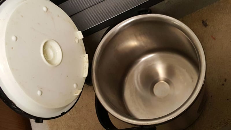

A confounding issue is the "structural" assembly. A vacuum chamber is held at the top symmetrically, and the inner cylinder is suspended inside the outer cylinder fairly securely. (And yes, they do break because the inner and outer bottle walls are (used to be) made of glass.)
the gel-type insulation is very, very effective but it has absolutely NO "strength against anything, even a breeze. Works OK in an attic for example, because it sits in a calm space with nothing to support, and is well-supported underneath the whole area. Even inside a wall, the aerogel insulation tends to "settle" into the bottom of the wall under its own "weight". Loose spun insulation blankets are less efficient (conduct more heat than aerogel) but at least they stay in place. Aerogel has to "sprayed" in place, so the inner and outer "liners" have to be positioned correctly and kept in place while the gel is "inserted". Obviously, this can be done, but you have to think through the assembly process completely. Painting? Coating? Extreme heat later in the process of assembly - as if your were going to use thermo-setting plastic - will "melt" the aerogel.
So, assume you have an inner "liner" and and outer "liner" of some stiff material. the supports between the two (since the insulation between the two parts has no strength at all) will be a thermal conduction path that will lower your thermal efficiency.

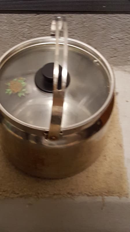

Perhaps you should explain what you are trying to build. Your initial description fits my thermal cooker to a T. Unless you are planning on have chimpanzees doing the cooking, I just can't see why you might think that anything you're looking at will work anywhere near as well as the stainless steel vacuum system. When one looks at products such as this, one has to consider why there are dozens of examples all using a vacuum system, and none using any other insulation. It's unlikely, after decades, if not centuries, of looking for a solution that dozens of companies have picked a stupid or impractical solution. Now, if the objective is simply lower cost, then the thermal performance must be sacrificed. See this for a discussion on design retained heat cookers (RHCs).

IRstuff, in the systems you've suggested a heated charge of food is enclosed in an insulated chamber and cooks by retained heat over a period of time. This is mainly suitable for wet cooking and requires a conventional heat source to provide the initial heat.
In primitive conditions (and in some cases for novelty value) something analogous is done with "hot rocks". Masonry ovens heated by a fire burned for some time prior to cooking and removed before introducing the food charge, which is cooked by the heat retained in the structure is another common mechanism.
The system I'm working on uses a phase change material in an insulated cylinder, with a removable insulated cover on one face and an optimized heat transfer surface on that face. It is intended to be charged by a solar concentrator (eg parabolic mirror) and store the heat for some time, then used like a hot plate to cook foods in traditional cooking vessels at some convenient time and place independent of the concentrator availability.
Quick description here: https://drive.google.com/open?id=1b1eGfmh5-gRCSaiW... (poster from IEEE GHTC 2015)
Briefly, my aim is to support traditional modes of cooking without traditional open combustion heat sources and to do so affordably and safely in a resource-constrained environment.

OK, seems to me that nothing has changed. In fact, the constraints are even higher, since you have a potentially much longer storage time, and you'll have much higher losses and inefficiencies, which means that a vacuum storage is all the more beneficial

Looks like I might still want to use that "boiler blanket" or something comparable for the lid insulation, disk-shaped vacuum-insulated structures aren't a thing that sounds practical.
How can I calculate (or estimate) the heat loss through a vacuum flask? Other than the neck (and possibly other structural members) the primary mechanism is radiation and that's not dependent on thickness of the gap, right? It doesn't have a thermal conductivity bulk property the way solid insulating materials do.
I guess I just need to find test results for actual examples?
RE: heat storage system fudge factors
You can use the Stefan-Boltzman Law: https://en.wikipedia.org/wiki/Stefan%E2%80%93Boltz...
Polished stainless steel would have an emissivity on the order of 0.08. Assuming an inside temperature of 227 C and an outer temperature of -23C would result in 266 W/m^2 of loss.

Thanks! I saw a version of that computation but without real-world application context or numbers. Having somebody who knows what they are doing turn the crank is reassuring.
The surface area is only about 0.3m2, ambient for most of my market will be around 20c worst-case (tropical and semi-tropical) and 250C or so internal is a good point to use for feasibility purposes, it's enough above the melting point of the phase-change material to serve as a "fully charged" number. If I had vacuum over the whole surface losses would be in the 100W area, or 360 kJ/hr. More than I'd like but within the feasible zone. Calculated losses using 35mm of "boiler blanket" are lower but costs are higher and I'm less confident of the real-world validity of that calculation anyway.
I'm concerned about the surface temperature near the neck/lid interface. Both the flask neck and the inner surface of the lid capsule will be conducting there and it could reach hazardous temperatures. Maybe the flask neck could be formed a centimeter or two below the cooking surface and something like a silicone ring installed there to separate the two.
Time to go into the lab. Not sure how I'm going to go about building a prototype with vacuum insulation, maybe my welder will have some ideas. Thank you again for sharing your experience.
