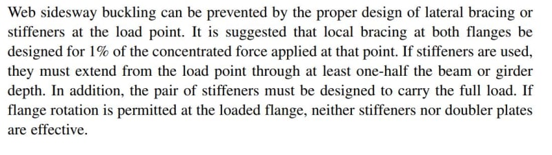

I feel that many of your answers can be found in that paragraph from AISC commentary. Additional comments:
1) For a stiffener to help, I believe that one of these conditions must be met:
a) The stiffener must be beneath the load and attached to a loaded flange restrained against rotation OR;
b) The stiffener, away from the load, must itself be attached to a compression flange restrained against rotation. Otherwise, the stiffener does nothing to prevent tension flange translation, the whole point of the stiffener in the first place.
Taken together, I believe that this means that stiffeners are useless for moving loads where the loaded flange is not restrained against rotation at all stiffener locations.
2) Clearly, stiffeners need not extend down to the unloaded flange.
3) In a hypothetical case where there were stiffeners away from the load but not at the load, and those stiffeners were attached to a flange unable to rotate, I think that the design checks would simply use the stiffener spacing as the unbraced length. And that would establish stiffener spacing.
4) Where your crane runs on a rail on top of the beam, I might even question whether or not that condition represents rotational restraint at the point of load application. In the absence of that restraint, neither web doubling nor web stiffening would be effective.
5) If it could be accomplished in a fatigue appropriate manner, a cost effective solution might be to attach a channel to the bottom flange. That's one of the few remediation options that doesn't require rotational restraint of the loaded flange.
