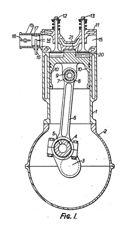

He is not the inventor, he is the re-inventor; it is an old concept that is explained very well in patent GB1156821, and even that is not the earliest example of the idea.

Side valves? Really, side valves??? I wouldn't give someone proposing side valves the time of day.
