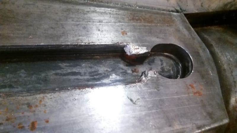

Looking to repair 4330mod 3/8" PJP on a 3" plate, V bevel.
YS 122ksi ; UTS 135ksi ; CVNs avg 50ftlbs @-4F ; 277/285 BHN
Will use E14018-G, although I have read also E8018-C3 can be used
preheat 600-650F
max interpass 750F
PWHT 1100F for 3hr
The results shall need to comply with CVNs avg 31 ftlbs @-4F ; 350 Hv
Any suggestions and/recommendations would be appreciated.

I'm curious why the repair is needed, and pix or dwgs of the part geometry.

I would recommend using a lower matched strength filler metal, E8018-C3 weld rod. I would also suggest you use a temper bead technique to enhance grain refinement in the BM heat affected zone. Drop the preheat to 450-500 deg F, and make sure you cool to below 200 deg F before applying PWHT to ensure complete transformation products.
For the deposit thickness of 3/8", I would PWHT for 30 minutes at temperature, you don't need 3 hours. Make sure the PWHT temperature is at least 50 deg F below the original tempering temperature of the 4330 mod plate.
Last, qualify a WPS with impact testing before you do anything.

For the PWHT I already checked the PWHT is -50F below the original tempering temperature
E8018-C3
preheat 500F
max interpass 750F
Temper bead layer technique with increased HI and 50% overlap aim
slow cool down to 200F
The final temper bead layer shall be removed afterwards
PWHT 1100F for 30min

In some cases, lower strength filler metal is selected recognizing that the repair is local and does not affect in-service performance. Being this is a 3/8" deposit on a 3" thick plate, this could fall into that category. The elevated strength filler metals can be tricky regarding delayed cracking and notch toughness. You will need nickel alloying in the filler metal, and having a lower strength can help meet this objective.

I agree there are thoughts in the industry that some try to match the filler metal strength and then have the consequent risk of delayed cracking and notch toughness. Others go for a lower strength to try and dilute this C from the base metal and soften the HAZ. The main problem with these materials is also the V that will precipitate and also contribute to the hardness of the areas. There are too many "inconveniences" when welding these materials, but it is possible. I just want to have an idea of other minds to have a starting point as I have never welded 4330 mod.
I think to start with I will also check with the designers to see the minimum design requirements and from there know how much of an undermatching filler is an option, as I think this will help a lot when welding.
