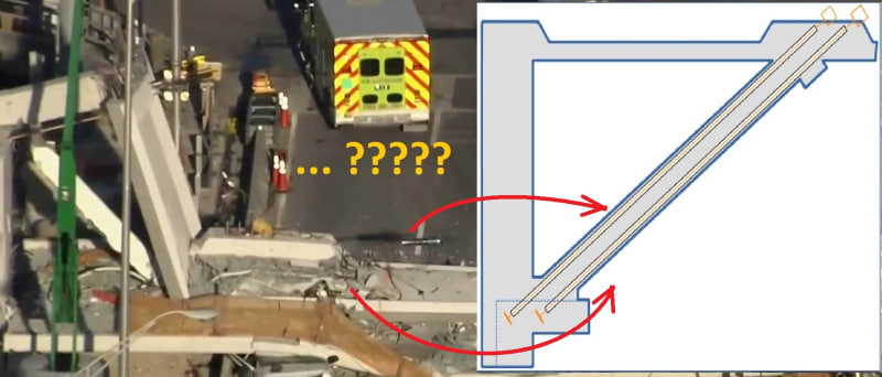

Right now I'm really more confused by this picture.

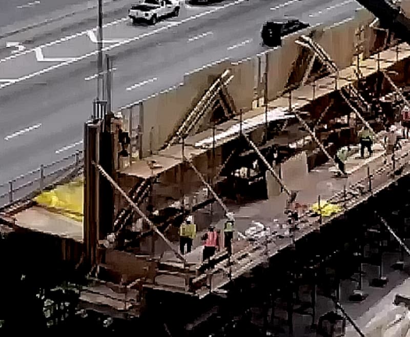

Video just posted on utube appears to shown bridge the morning of collapse
At 8:53 AM, westbound travel appears to show worker on south end canopy. No "apparent" north deck blemishes or cracks---video is fuzzy somewhat.
At 9:39 AM, eastbound travel shows crane setting up, maybe the man lift basket in roadway.
www.youtube.com/watch?v=CVjBiFMXjwU

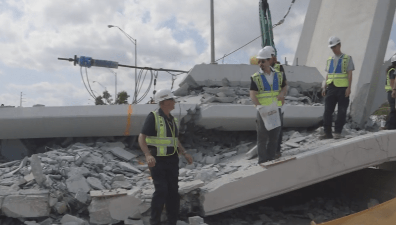

Lastly some have raised the suspicion on the tension adjustment equipment and wonder if the members were further compressed. Two facts are relevant here:
Quote (NTSB news release 3/21/2018)
"The investigative team has confirmed that workers were adjusting tension on the two tensioning rods located in the diagonal member at the north end of the span when the bridge collapsed. They had done this same work earlier at the south end, moved to the north side, and had adjusted one rod. They were working on the second rod when the span failed and collapsed. The roadway was not closed while this work was being performed."
(1) The crew was adjusting tension. It can be increasing or decreasing tension. Since No.2 and 11 are permanently under compression in service one would have thought the original tension introduced to counterbalance the overhanging cantilever action would be removed in the tension adjustment. Any suggestion of the No.11 failed by compression could be speculation unless newer information is available.
(2) It would be speculative to blame the equipment or the workmen if the crew has adjusted successfully two PT rods on the south and one in the north.
RE: Miami Pedestrian Bridge, Part V
Quote (Meerkat 007)
After primary failure at base of 11, I believe there was significant secondary grinding going at base of 11 prior to bridge collapse, with vertical 12 still in place. Other members begin to fail around it--first top canopy, then finally bottom slab. When bottom slab hinges and rotates prior to being pulled off of pier, this could force top PT rod out from top canopy. Then what's left of 11-12 are thrust off slab and onto top of pier as bridge plummets to ground. Of course, this is just a theory?
[[EDIT: Scratch the rotation of bottom slab thought, as it is the bottom PT rod, not the top as I mentioned above, that extends from the anchorage blister.]]

Meerkat 007,
I do not know what your last drawing depicts either.
However it is reasonably established the top PT rod of No. 11 has been adjusted successfully. The bridge broke when the crew was adjusting the tension in the bottom PT rod because the jack was still attached to the rod after the collapse.
Where we like it or not the tension adjustment of the last PT rod, at the bottom of No.11, triggered the collapse.

I'm confused by this :
Thanks all for response.

Remember that the upper PT rod was adjusted at the lower end so the top end may be cast in the concrete.
The upper PT rod has stayed with memmber 11.
The lower end of the lower PT rod seems to be still attached to the deck.
This may indicate that the failure originated mostly above the deck.
Bearing in mind that the photos may be misleading.

Quote (Meerkat 007)
Not sure what you are pointing to inside that red annotation. Perhaps it's the white PT tube, and you're wondering if it's the lower PT tube of #11, which make the adjusting one the upper PT tube? (Except an upper #11 PT tube is visible in other photos.)
I the one you're looking at is more likely the most inboard of the canopy's PT tubes.

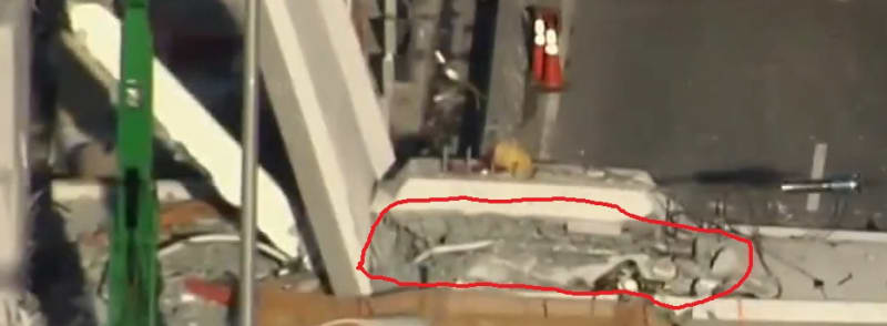

This confuse me. For my untrained eye looks like a PT bar but from where to where ?
Can be from canopy or is just rebar ?
Thank you all for response.

Meerkat 007
"This confuse me. For my untrained eye looks like a PT bar but from where to where ?"
I believe that it is tendon duct or utility duct from the canopy but could be wrong.

Quote (appster)
Meerkat 007
Looks like 11’s upper tendon to me.
Nope. That’s not it. Maybe an empty duct left from where 11’s lower tendon ripped through? Tough to say.

UKJIm
I was referring to the white snake going almost full length of the blister. Can only hope that the NTSB keeps a few larger pieces such as what is left of this cap and what is left of 11 and 12 to examine more closely.
Quote:
UKJIm
Yup. Sorry. I see that now. Hard to tell.

Quote (chris snyder)
27 Mar 18 00:32 picture of #11 lower tendon plate
Nice photo and find. Where is that photo from?
gwideman: "Where is that photo from?"
Part IV Incentive 24 Mar 23:01.. have seen others (Meerkat 23 Mar 17:53 and elsewhere online) but this was highest res. He's got good points there - all of it sticks in my mind (esp 'blowout' residue on that beam by the canal). Just noticed how rebar is bent out bottom of #12 (assume when it got pushed/broke from end beam), but ~straight from bottom of 11.
Quote (PE2015)
26 Mar 18 21:53 Video just posted on utube appears to shown bridge the morning of collapse
Just want to draw attention to this earlier post. The linked video, shot from approximately the same angle as the dashcam collapse video, is quite useful in showing the various visual distractions around the north end of the bridge, including a tree in the background, and a lamppost in front.
One may also see how the north west corner of the deck visually protrudes "beyond the end of the bridge" as the car moves east. However, it's debatable whether it does so at the right rate to correspond to the similar visual appearance in the dashcam video.
LittleInch:
Fm 00:32
"Below looks like #11's upper duct and rod plate/nut protruding from a shattered end. "
this refers to the photos (easy to understand)
"#11's upper rod/duct (not pictured, at ground level - as you already know) was stripped from the member."
This should say "lower rod/duct"... thanks and sorry about that.

5
I re-post some 23 Mar 18 10:54 photos from gwideman and wish to point out some anomalies to construction/structural people.
These two photos confirm (1) there is a construction joint at the interface of the walkway deck with No.12-11. (2) There are 4 vertical plastic sleeves or pipes, look like about 3" diameter to me, cast with the deck. Two on either side of No.12. There are some reinforcing steel bars, possibly for anchorages for other installation, and blue flexible small ducts or conduits, which I think could be tubes for grouting and de-airing the PT ducts in No.11.
There is nothing odd about the above items. However a construction joint if not properly prepared is a plane of weakness and can never be as strong as a monolithic construction without such joint.
The photo below is the best I could blow up to show the anomalies in details. It has been posted several time before.
I find the photo odd because
(a) The No. 12 has gone but the 4 white plastic pipes are there. The tilted one appears to have suffered some damage. If No. 12 was pushed out shouldn't it take out the 4 plastic pipes too? Concrete is much harden than plastic. So such condition would suggest bottom of No.12 was disintegrating when it left its position on the deck so that the small broken concrete pieces could not drag the plastic pipes away.
(b) The No. 11 has gone too. That is expected but shouldn't we find some reinforcement that connect No.11 with the deck here. I can see one or two small size bars around the foot of the investigator who was looking at the anchorage of the bottom PT rod of No.11.
(c) The first two drawings clearly show the 4 plastic pipes cast outside No.12 but the hole shows the 4 pipes are inside it. Has part of the deck also disintegrated too to leave behind the plastic pipes intact?
(d) Between the far end vertical and tilted plastic pipe, near the investigator's foot, the surface of the hole looks remarkably clean and straight as though it was formed by formwork and not ripped out from a homogeneous concrete mass. The only possible explanation to have such good surface "finish" is this area has been boxed out when the deck was poured. There afterward the 4 plastic pipes were installed and the void was filled with second stage concrete. Nothing wrong with this construction as it happens all the time on site. However it would be suicidal to do it at a joint that has to provide restraint to arrest a huge horizontal force from No.11.
(e) The only reinforcement of the deck in this photo is at one location a couple of small bars located between the undamaged vertical pipe and investigator's foot. The amount and size don't look like proper deck reinforcement to me. SO if this area has been boxed out did the workmen trimmed the reinforcement around it too?
To assist understanding I provide my own interpretation of other items in this photos.
The steel plates and other plates stacked against the abutment could be the remains of the bearings. The plastic pipes could be for the holding down bolts which in the proposed drawing only two were indicated and they are a lot far away from the No. 12. Other photos show no holes for the hold down bolts. gwideman other photos has depicted what looks like two holding down bolts on the abutment but the plastic pipes can also be conduits for other services. The back of the No.12-11 area has some 5 reasonable steel bars and a few smaller bar bent against the abutment wall. They could be the rebar linking No. 12 or 11 with the deck.
I have been haunted by the above last photo ever I saw it. Many of us talk about horizontal shear in No.11. A shear could only happen if one part moves while the other part remains stationary. Looking at the above photo and what have left in No. 11 and 12 make me think may be the supposed stationary part of the deck had moved out first to trigger the collapse. It is not really that far fetched if there is hardy any reinforcement provided to "restrain" the No.12-12 from moving outward. The concrete alone is unlikely to stop the two vertical triangular faces beneath the deck to shear off vertically. The back of No.11 could out by tension. Any reinforced concrete designer knows concrete has very resistance (in similar order as the shear resistance). The nearly untouched condition of the 4 plastic pipes does not inspire confidence the construction quality at this location. Furthermore if Tony Pipitone report were to believed during failure the tension adjustment has to increase tension, since the tension was released in the first round, then the crew was pressing their luck by pushing the No.11 out of position by increasing its axial compression.

Saikee119, I agree with your comments on the above photos regarding the lack of observable reinforcement at 11 base, and the fact that the PVC pipes are nearly intact. Seems odd.
Something else to add to the discussion, and that is the fact that member 10 is seen punching through the bottom slab in the final moments of the collapse. Is this merely a random part of the process, something that is inevitable based on the geometry of the truss members? Or is the timing of this violent load reversal indicative of something else?
First figure depicts structure (member 2 -- top canopy -- member 11) viewed as an arch, with horizontal and vertical restraining forces at either end. Note member 10 in tension:
Second image is with horizontal restraining force removed at north end. This needs to happen prior to member 10 going into compression:
So my question is, can we deduce anything about when 11-12 base area disintegrates, thus eliminating the horizontal restraining force Hn, by looking to see when member 10 is driven through base? Or is there no connection whatsoever?

saikee119 (Structural) 27 Mar 18 13:54
Very good post. About the haunting photo of the demise of member 11, I would like to point out, if not already known, that this was a screenshot from "NTSB B-Roll". I would be pleased to read your observations on the full video if you have not seen it yet. You are on to something here. Thanks.

Gwideman,
I realize that the remains of member 12 sitting on the pier closely resembles what member 12 looked like before the collapse, with a piece sticking below the main deck.
However if you go and look at some before and after photos using the re-bars sticking out the side of member 12, you can see that in fact the bit left on the pier was originally above where member 11 connected. There is a missing section of member 12 (the bit sticking out the end of the cross beam) which is either in the canal or is still attached to the end of the deck.

LittleInch... you're right - I just saw that.
Fm Meerkat007 IV-23-13:43 - Member 12 damage overlap superimposed (slick photo)...
which explains why something looked odd with no sign of the PVC pipe this photo.
The 'clean' bottom end break looks like it sheared from the deck surface (as if a second pour - other photos show a difference at this point on the 'back' of member 12). The semi-circle face of 12 is odd... like an explosive blast hit it.
This makes me wonder what happened to the small extension 'block' (bottom of 12) with PVC pipe that was on the end of the deck. Photos of the other side of pier appear to show scrape marks along sides of the face as the deck slid down, but no scraping in the middle.
This photo also answers my above question... the top of 12 is mangled but it didn't break off.. looks like rubble held in place (with rebar?). The video appears to show the 12-canopy angle decreasing like a hinge, but it landed at ~right angle... there's also some web cracking up there.

Evidence member 11 crushed base of member 12. Remnant of banner from member 11 pinned between pylon and rebar.

The fact that the dead end of the lower PT bar in member 11 stayed with the bottom slab when it fell indicates that the failure plane was obviously above the anchorage. We don't know exactly where this anchorage was but it would have needed to be above the 8" drain pipe. This holds for the top dead end anchorage as well. These PT bars were not grouted and therefore would offer no dowel-action in resisting shear on the assumed failure plane (cold joint). If they crossed the failure plane, their stress component perpendicular to the failure plane would help clamp the joint together, while their tangential stress would tend to cause a shear friction failure. Again the angle is such that the latter would be dominant.
At this point it looks like member 11 could have failed at or near the deck surface taking out member 12 in the process. This would destroy the truss action and lead to failure.

I am afraid you are behind with the history. First the north side has a concrete barrier making the original transporter configuration too much work. A change was introduced probably necessitated the PT rods introduced in No. 2 & 11 as No.11 according to the proposed drawing has no PT system. The revised transit support arrangement has two overhanging cantilevers causing No.2 and 11 suddenly taking tension not anticipated in the proposed drawings. The change broke the bridge indirectly!
This was how the bridge supported during execution.
You can see the concrete barrier or divider here. It broke the fell bridge by locally hogging when the bridge failed by sagging. The sagging point is at the lower left corner of the photo.

The crews have to increase the tension in order to back off the nut to relieve the tension.
The failure appears to be shear or crushing of member 11.
The PT rods do not appear to be broken.
The crew had the jack on the lower rod of member 11. In some of the pictures he lower end of the rod appears to be anchored into the deck. Had the rod broken it is doubtful that it would have zippered out of member 11 as much as it did.

A different thought: Look closely at the rebar as it protrudes from the broken concrete.
It's pristine, clean, clear of ANY concrete blocks or remnants or pieces. Only a light coating of dust. As if the rebar were "oiled" or painted/didn't adhere to the concrete around it.

The clean bars were prestressing bars, not normal grade reinforcement. They were not bonded, just anchored at each end. Whether they were to be bonded by grouting in the final structure, I don't know.

(2) NTSB B-Roll video clip shows the bent threaded PT rod, how it rip out the concrete and broke the shear links in No. 11
Not so fast.
1) Don't believe the post-tensioning procedure has been seen. This should be documented as a work procedure.
2) Does adjusting the post-tensioning procedure include chipping out space in the anchor blister for the hydraulic jack? Was the worker chipping concrete at the time of collapse?
3) Why does the post tensioning rod nut extend so far into the anchor blister?
4) What is the white dust that is seen around the worker shortly before the collapse?
5) Final as-built drawings have not been released and some parts of the structure are different.
It is all conjecture until what the post-tensioning crew were doing is documented.

Photos of the concrete blister on top of the truss canopy where the tensioning operation was taking place at the time of the collapse indicate that concrete chipping was necceasry. The surface around the anchorages is rough and uneven and there is a chipping hammer shown in bimr’s last post.
But photos of this same area during the roll in show the same uneven rough surface around these anchorages. Why is that? Was there some uncertainty surrounding these anchorages before the roll in that required their anchorages to be exposed? Why would access have been a problem if the plan had all along been to de-tension the bars after the girder was placed? If that was the case why not properly form a ressess for the future work?
I agree, more info is needed in order to go further.

Do these two photos show a crack around three sides of the bottom of #12, or is that just an illusion?
From an earlier post about the pvc pipes:
From the end of the video taken by the camera on the end of the bridge during the move:
I believe that the 'crack' you're seeing is the cold joint between the deck and web members.
So not really a crack, but sort of a crack....

Quote (bimr)
The rod must be long enough to accommodate the nut, when in the untensioned state.
Additionally there must be enough added length to attach the tensioning jack.
There may have been a little extra length as a safety factor.
Hence the extra length of the rod protruding out past the nut.
Although the rod in member 11 was not permanent, normally the cavity in the blister must be deep enough
that the protrusion of the rod may be completely covered with concrete or grout when the final tension was set.
Bill
"Why not the best?"

Quote (waross)
The extension of the PT bar beyond the nut must accommodate AT LEAST half the length of a mechanical threaded coupler (see photo below, which are 8-1/2" long for a 1-3/4" PT bar). A short, temporary "pull bar" is most often used, and it connects the stressing jack to the PT bar assembly. A stressing stool (usually a custom-made heavy-walled tube with a annular bearing plate, and a reinforced side-wall cutout) is used that bears on the tendon bearing plate, and enables the pull bar, nut, washer, and coupler to freely elongate, and also enables the stressor to then adjust the nut.

1) there does seem to be a projectile. I thought maybe a small chunk of concrete broke loose when rods popped out a bit at first shift (assuming the cold joint at base of 11/12 moved as shown in gwideman's diagram, IV-23 Mar 18 17:09). The jack's contact surface would need to be cleared, but not the corners of the bearing plates.
2) I can't find good photos (wanted to compare how much thread was exposed), but the 2-3 blister was also chiseled open. And not sure how much, but chiseling up top would send impulses to lower end - not good if 11-12 to deck was cracked.
3) there may or not be dust, but chiseling would be done before the jack was placed - else the jack would be in the way.
4) maybe others know, but I think I see another worker up there barely visible to left of crane (maybe he stands just before collapse??). Article said a worker latched his harness a 'few seconds' before collapse when he heard a crack and credits this with saving his life (in reality, this could have been less than a second). I get a sinking feeling seeing Navaro Brown (R.I.P.) fall with that harness dangling, and harnesses laying on top of the blister.
https://wcinsights.com/worker-dies-in-fiu-bridge-c...
5) gwideman's loop makes some things apparent. Like the 11-12-canopy triangle holding together. On frame 6, (to me) it appears the 11-12 connection which has moved north (sheared together, covered with black banner) grays up and gets blurry like it's beginning to 'explode' - this point moves off screen after this happens (some videos don't even show it).
I suspect the 11-12 joint 'exploded' when it was over the pier - as the canopy came down and "chopped" a few feet off the top of #11 because the canopy broke at the north edge of blister (seen in video). It would take a tremendous amount of energy to pulverize that much rebarred concrete and that joint compressing (like squeezing a wishbone) might do it.
Tony Pipitone seemed definite about the rods being tightened, AND (angry) when he said "stress test" was a "misnomer" (a tactful way of saying it was a blatant lie). There was no reason to tighten rods on compressive members (now I know why you all wondered if they were de-tensioned). Mr. Pipitone also said ~"WORK was being done to address what was discussed at the meeting" which I take to mean the cracks, but he didn't say that (though I sense he knows), and is angry about them doing such work with people/cars below. Marco Rubio's tweet (first info to come out) also said they were tightening the rods.

Chris - the blister openings were like that before the bridge was transported. The tensioning of all the members would have to happen before lifting the bridge. The "harness" was likely the sling used to lift the hydraulic jack into position.
Quote (3D Dave)
Ah yes - I see now looking at overhead when span was being moved. There was question if these were filled when placed - supposedly tensioning [which could be detensioning] was completed the day it was moved, then [tensioning] re-done after cracks appeared. Saikee119 said unsealing blisters would be a big deal and require discussion, etc. Question first arose from seeing small jackhammer in rubble.

Ingenuity
Thank you for the picture and explanation of the threaded coupler and further explanation of my post.
On another topic:
I have been wondering about the picture of the pressure gauge.
The needle on many gauges is a press fit on the shaft. I have seen some pointers moved by pressure pulsations or by a sudden application or release of pressure.
Rather than jump on this picture as evidence of over pressure, I am more comfortable with the theory that the needle has shifted due to abrupt pressure changes during the collapse.
The background to the photo and the red line apparently spray painted past the gauge may support this theory that the picture was taken post collapse.
Comments?
Bill
"Why not the best?"
Jimmy Carter
Chris - anything is possible. I do note that the tensions on both #2 and #11 would need adjustment after the move, but only #11 is associated with further concerns, so if they had filled the openings after the post-move adjustment, why would they also open #2, which was intended to be tensioned in the original plan versus #11 which was not to have any tensioning at all.
This makes the jack hammer a puzzle, but the photo is after the start of rescue and recovery efforts, so I don't know if it was in use on the top of the bridge.

saikee119 (Structural) 29 Mar 18 00:20
[...] (2) I don't have facts on this one but chipping out obstructing concrete to access the PT rods and nuts. Such work would need permission from the consortium engineer team. The NBC investigative reporter Tony Pipitone said the initial tension adjustment had been executed before the road was re-opened. The contractor might have sealed the pockets with mortar, temporary or permanently, to protect the steel from rusting. Once the tension adjustment has been completed the consortium has no reason to reopen the access pockets.
chris snyder (Electrical)29 Mar 18 02:27
It appears the lower blister is grouted.
If only we had minutes from the morning meeting!
