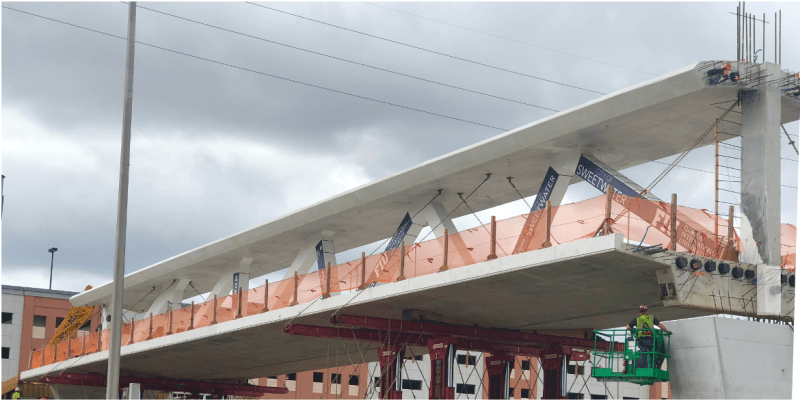

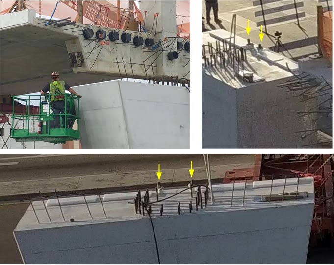

Further details of the 11-12-Deck connection area, (which has become of interest here, though not to argue that other areas are ruled out, particularly the junction of 10, 11 and canopy).
From videos posted at: https://www.dropbox.com/sh/u8qicuu22xmfhg1/AADPXPe...
which was mentioned in this forum by jrs87 -- thanks.
A couple of images from the bridge shortly before move.
Main point of interest: the approach of #11 to #12, and to the deck. Note the "fillets" between #11 and #12, and between #11 and deck, which I had not previously noticed. A yellow arrow indicates white pipe with red tape or paint on rim that correlates to a later image.
The area pictured above corresponds to the area captured from the NTSB B-roll footage, which I previously posted, wondering the function of the rods marked with yellow "?". These rods are enclosed in white plastic pipes; the one on the near side bears red tape/paint:
I had previously thought that these rods and their enclosing pipes were within the footprint of #12, but apparently, from pictures above and below, they are just outboard. I also thought that the other pipe on each side was perhaps part of services to be supplied up inside #12, perhaps along with additional channels in the void between the pipes. However, to me it now looks like the void between these pipes is simply where the base of #12 tore out at some stage in the collapse, leaving connecting rebar bent over to the extreme left of the picture.
Steve Nuchia suggested these rods might be for position keeping. I think the following images show that the rods indeed tie the bridge to the pier, though they are not in the position shown on the proposal drawings, but have moved inboard. I'm thinking that the protrusions seen on the pier were extended in some way after positioning the span, so as to stick up through the deck's end-beam and out of the white pipes on each side of #12. These images are from drone footage during the move.
I imagine at some point we'll get to see photos of the cracks that were reported, and see whether they are in the 11-12-deck neighborhood.

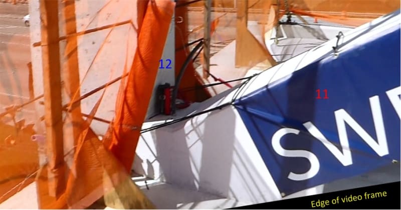

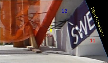

RE: Miami Pedestrian Bridge, Part IV
Very interesting image + graphics by Meerkat 007.
I've now seen a couple of images that make it seem fairly certain that the junction of #12 at the canopy remained intact and rigid 90 degrees.
If that is the case, then the initial action would not have been crushing and shortening of #11, but rather the junction of #11 and #12 tearing out of the end of the deck, and thus 11, 12 plus the end of the canopy rotating as a more or less intact triangle. (For what it's worth, Alfie.Tx described this earlier while I was still favoring crushing and shortening of 11).
Meerkat 007's interesting stick model animation (22 Mar 18 12:04) with #11 missing, that compares well to the fuzzy slo mo dash cam video, has a couple of unsatisfactory aspects. It doesn't maintain a right angle at 12-canopy, and to make the geometry work out, the end support moves inward horizontally. If instead you have the 11-12 junction slide to the left (north), and maintain the 11-12-canopy triangle, at least initially, I think it works out better. That could match the dash cam video, since #12 is obscured from view by the crane.
Now once the triangle rotates a bit, and the collapse is underway, the canopy cracks between 12 and 11. The former upper end of #11 breaks due to rotation at 11-10-canopy, and is also crushed by the falling northmost segment of canopy. Meanwhile the former lower end of 11 (near 12), which is already damaged by the tear-out, smashes against the top of the pier. But 11 is partially maintained in its position in the triangle by its upper tension rod remaining connected at both ends.

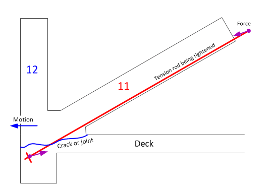

jrs87: Assume you mean "consensus"? I can only state my consensus with myself, which doesn't count for much, not being qualified in this field.
However, I am tempted to think that just by geometry, if the 12-canopy junction maintained its angle, that precludes the action starting with #11 shortening. But maybe concrete+steel is more flexible than I imagine.
As to why it happened during PT rod tensioning or detensioning, I don't have a comprehensive theory. For one thing we don't know where the PT end plates are.
We do know the lower tension rod was the one being adjusted, and it stayed with the deck. So if it was being tightened, then it would have increased the force pushing #11 out the end of the deck, I guess. Straw, camel, etc.
4
jrs87 got me thinking about why might tightening of the tension rod precipitate ejection of 11 and 12 from the end of the deck.
IF that occurred, here's a possible model:
And we don't know whether they were performing an overall tensioning or de-tensioning operation, but as has been described earlier, even detensioning requires first some tensioning to loosen the nut. That small additional tension wouldn't explain why there's a crack in the first place, but it might explain why, given an existing crack or poor joint, the collapse occurred during the adjustment operation.

gwideman, your diagram does make sense, the lower PT bar did in fact stay with deck (it zippered out of 11), and the upper one stayed with 12 after collapse.

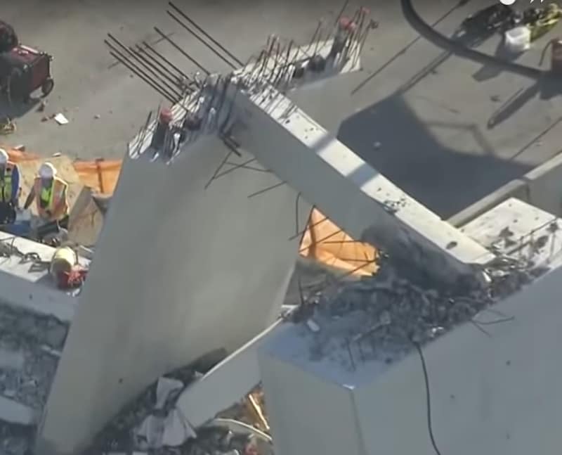

I am rethinking the shear surface. The skid marks and impact on the pier are along each side not in the center where the extension of member 12 would have impacted and slid. Perhaps the failure occurred through the white pipes with red on top. The photo of the NTSB worker digging through the rubble looks like there is a void between the two sets of white sleeves. The pipes would have made a weakened shear surface. Thoughts?
Quote (RetiredSE (Structural))
Concrete of member #12 base was pulverized before north deck end fall.
You can still see skid marks of like 2 rebars on pier surface.
Note the white pipe in deck is matched on canopy if I'm not mistaken. The bar couplers shown on NTSB deck photo connect bars up to canopy? The rebar (looks like tv antenna) on 12 may have been meant to tie 12 with other section simply to form hexagon shape shown in plans.
Quote (Meerkat 007)
Agreed.

gwideman, given your assumed shear failure plane with the PT bar crossing it, tension in the bar would create shear friction, a clamping action tending to keep the two interfaces in contact. If the bar was detensioned, this would tend to reduce the shear friction and increase the likelihood of failure. Because the bar was in an ungrouted duct, the bar itself would offer little resistance to a shear failure, and given the other elements in the vicinity of the joint tending to reduce the effective area resisting shear, such as the 8" drain pipe and other ungrouted PT ducts, removing tension in the bar could cause failure.
I assume the bar was being detensioned because the PT was primarily required for the transport operation. Once the girder was seated on the pier, and compression introduced into member 11, the need for the PT, for the sake of strengthening member 11, would become unnecessary. We don't know if the hydraulic jack operator was just starting the detentioning process or was nearing its completion. It is possible that he was at the end of the detensioning process when the bridge failed.
Additional comment: There does not appear to be any actual joint reinforcement of the type one would find in a bridge designed to resist seismic forces. This type of reinforcement would have helped confine the concrete in this high stress zone, making it more ductile and less prone to a catastrophic failure. The innovative design, the lack of redundancy and the high stress concentration at the interface between the deck and diagonal would have made joint reinforcement a prudent choice. It would have added little to the cost of the design while providing a substantially more robust structure.

It is possible that Member 11 and 12 became detached from the walkway during the collapse but the same photos show the top of Member 11 still attached to the top chord or canopy which has a much more robust joint arrangement. However the canopy folded just before the robust joint section.
The broken-off end of Member 11 has rebar I estimate mostly small diameters like 5/8" to 3/4" and does contain any transverse PT duct or tendon. The densely spaced 67 number of transverse PT casing has a concrete cover of 3.75". This could suggest the Member 11 could have shear off outward to the North with a layer of maximum 3.75" of the top concrete from the walkway. The downstand beam here is also only 2'10.5" wide. The south side, with a 3'6" downstand beam did not collapse and still have the canopy and walkway separated by middle truss after the collapse.
There is no code to help a designer on how much steel reinforcement to put in to dissipate the stress. It is down to experience and to realize the design assumption that the joints are rigid enough. When the reinforcement drawings are available a more definitive assessment could then be made.
The evidence so far points to the Member 11 wasn't adequately reinforced/connected to the 2'10.5" wide downstand beam and the walkway. May be the embedded longitudinal PT anchors were in the way but the designer must have a scheme to pass the axial tension (occurred during swingin-in) and then compression (in service) into the walkway because the truss system lies in the middle empty 3'1" corridor where there is no longitudinal PT system.

From the photos above by Meerkat 007 and JRS87, damage to 12 base appears to extend nearly to mid-height! And in the "end on shot" of 12 there's a stub that extends from the base that is almost semicircular, as if the front side was pummeled, causing the weaker corner edges to be chipped away. It's hard for me to see how this could happen if the 11-12 base sheared off together as a unit at the construction joint/ deck surface.

Meerkat007 and jrs87 photos show the steel reinforcement of the broke-off end of Member 11 still firmly attached to Member 12. However no significant reinforcement is visible between these two members with the walkway which is supposed to work as the bottom chord of the truss.
The left-over of the Member 12, which is still on top of the pier, is a strong evidence the Member 12 have detached from the walkway by a horizontal force overcoming the shear capacity of the connection.
Meerkat007 has identified the bulge in the 17/19 seconds of the Zac Doyle Youtube video. This collaborates rather well with gwideman's shear failure sketch posted 23 Mar 18 17:09. When considering the positions of the longitudinal and transverse PT systems and comparing them with the photos it is possible the shear plane might have occurred at a slightly higher lever.

Quote (saikee119)
I see the reinforcement of 11 as entwined with 12, not firmly attached, and it is entwined higher up 12 than its original location.
And in the 4 screen grabs by INCENTIVE immediately above, member 12 looks to remain in the vertical position for the first 3, well after the postulated debris is blown out of the end.
And in one of the earliest posted videos by Tomfh in Thread I, 18 Mar 2:42, member 12 actually looks, of all things, to be pulled inwards. Of course its final resting place is on top of the pier, so 11 would have to push it out in the final moments.

The the end-on photo of 12, I see a faint sign of a large perpendicular bore hole in fracture.
Does anyone know what deck rested on? In photos I see what appears to be 4 nylon bearings at top of pylon pier. Are these spaced in such a way 11 can punch through deck? I don't know.

A later post indicates that the depth of member 2 was increased leading to a much longer footprint for 2 meeting the deck at such a flat angle. This longer footprint gives more shear area at the deck to transfer its compression load into the deck and also brings more tension strands in the deck into effect in resisting the tension in the deck from the compression in 2. Major difference between North and South end to explain why south end did not fail first.
Quote (pontduvin)
That thought crossed my mind too, especially that loosening could precipitate the failure. But much depends on the positioning of the PT rod endplate, the angle relative to the crack/joint, etc. My sketch was only meant to illustrate the idea that changes on the PT rod could be somehow correlate to the time of failure. Likely the endplate and the crack/joint would not be exactly where I showed, especially of #12 got pushed out right to its bottom.

Quote (TheGreenLama)
I think there may be some confusion over the motion of #12 because behind #12 there is a tree. As the vehicle and camera moves, due to changing perspective the tree moves rightward relative to #12 in the foreground, possibly making it look like #12 itself is moving.
Here's a frame from earlier in that video: https://youtu.be/Ucflj-MsJBI?t=4 , in which the tree in question can be seen to the left of #12.

Regarding 11-12-deck, I wonder if a structural engineer might comment on how such joint systems work typically? What they might expect to see inside this bridge?
The ongoing discussion leads me and some other posters above to wonder how the design intends to route stress from #11 to the deck's tendons. For orientation, we're discussing this area:
A naive first speculation might be like the picture (plan view) below, which troubles the mind because of its poor distribution of forces to the tendons. (I think SheerForceEng remarked on this):
So perhaps the idea is like in the following image: #11 presses on the deck end beam, which in turn acts as (or contains) a very stiff bar distributing the horizontal load to the tendons. Is that feasible?
Or might the horizontal load from #11 be constrained by rebar that folds back south (rightward) into the deck for some distance: Either rebar in #11 folding like a hairpin under #11 into the deck, or L-shape rebar, with one leg vertical in #12, and a horizontal leg into the deck. Those horizontal legs in the deck could be long enough to spread compression broadly into the deck, to be resisted by the tendons?
Might this last scheme, if a valid approach, correspond to the rebar seen at the left of the NTSB "rubble" photo earlier on this page, apparently torn out of #12?
Great schematics!
If shear failure at the ends of the structure was the cause, it seems that an approach more towards a solid web of the I-beam by both ends could have added some safety factor with little penalty regarding materials, weight and "aesthetics".
For example, another horizontal beam resting on the lower deck, with horizontal PT elements running between the low portion of the two last diagonal members of the web.
In other words, forming a self-supported triangle that liberates the end of the lower deck from additional tension and shear loads, as well as those diagonal members and their nodes from bending loads (element 10-horizontal beam-element 11 and element 2-horizontal beam-element 3 triangles).

appster - differing from the preliminary plans, the as-built bridge approximately doubled the depth of member #2.
See the post by SomewhereOverChina (Electrical)22 Mar 18 03:32 on http://www.eng-tips.com/viewthread.cfm?qid=436802
His example photo:

Regarding the protrusion at the left end of the deck, shown in the time-lapse video right before the failure initiated, I think gwideman is correct, it is just the deck corner coming into view as the position of the camera continually changes position.
We know that lower PT bar in member 11 crossed the failure plane at the end of the deck because its anchorage remained in the deck section after the collapse, causing the bar to be ripped out of member 11 as it fell. This supports the theory that the horizontal failure plane was located somewhere near to that shown in gwideman's sketch.
It also appears that the deck section remained nearly intact after the collapse. This seems to imply that the longitudinal post-tensioning in the deck did not adequately participate in transferring the compression in member 11 to the deck.
The failure resembles a punching shear failure in a pile supported footing with no pile under the column, only in this case the column was at the edge of the footing. The only benefit of member 12, and the future pylon, in resisting shear failure, other than a bit of confining compression pressure on the joint, is that they necessitated the need for vertical mild reinforcement through the failure plane. But the contribution of this steel would be minimal until the bridge was completed.
It is unfortunate that a longitudinal PT strand was not positioned to run down the middle of the deck as this would have directly resisted the punching shear of number 11 transferring the load directly to the deck by confining the end of the girder with a PT anchorage plate. The location of the 8" deck drain may have prevented this...an unfortunate tail wagging the dog effect. This drain pipe also seems to have dictated the temporary bearing locations on top of the pier preventing a reaction point directly under member 11.
The devil is indeed in details, especially in a modern concrete bridge where member sizes are minimized using PT to reduce weight, and aesthetics drives compromises in the placement of structural elements. The deck section was relatively thin given the localized demand placed on it by member 11 at this stage of the construction.
Take a look at the opp end. #2 appears to be a deeper member. Dashcam vid proves it took a licking and kept on ticking. In the prelim dwgs, it is same cs area as all the others. So, it appears someone ran the numbers again and decided to increase the area of #2 and not #11.

If the preliminary drawing is accurate, unlike member 11, web member 2 (type B) was specified to have two permanent tensioner bars loaded at 200 KIPS each (please, refer to SheerForceEnd's post of 24 Mar 18 01:10 above).
To resist buckling under gravity of the more slender and horizontal member 2 perhaps?
That was specified prior the adjustments for transporting the structure while both ends where protuding beyond the jacks were made.
Those adjustments for temporarily resisting the negative moments (compression at the bottom of the I-beam and tension on the top) at both ends could have been adding two new tensioned rods to member 11 and increasing tension above the specified 200 KIPS in rods of member 2.
If that is true, tension for member 2 could have been only reduced, but keeping the specified values, which could have helped keeping the integrity of the lower node (end of slab, diagonal member 2, column 1) under shear and bending loads.
Perhaps the opposite end of the bridge (by member 11 and column 12) did not have that structural advantage if the directions were to release all the tension in both bars.

Did member 11 fail due to crushing near the connection with member 11.
A crush failure would allow the member to effectively shorten and lead to the failure of the deck.
A crush of a portion of member 11 may account for the burst of dust seen behind member 12 immediately prior to the collapse.
Although the end of member 11 may have crumbled, effectively shortening it, it may have retained enough length and strength to hold the bottom of member 12 on top of the support as the main deck fell.
The damage to the bottom of member 12 may be consistent with the main deck falling away and breaking free from the support.
The rebar from member 11 and member 12 look to be running to the top of the support.
Once the 11-12 connection broke away from the main deck there is little save gravity to hold them on top of the support.
The damage may be consistent with the top of member 12 being restrained by the top canopy and the bottom of member 12 being restrained by the remnant of member 11 as the main deck fell and rotated away.
Note also that the end of the PT rod embedded in member 11 is still attached to the deck.

Where are the rebar linking No. 11 and 12 with the walkway?
The following photos were provided by gwideman on 23 Mar 18 10:54
They depict the locations of four plastic ducts, two on each side of No 12, before the collapse.
After the collapse gwideman showed the walkway deck with rubbles. The deck rest on the ground and tight against the abutment wall after the collapse.
The four plastic ducts are now visible but No. 12 member has gone. The long PT duct shown belong to No. 11. Thus the original footprint of No. 12 and 11 on the deck is in the above photo.
VolsCE84 has drawn the positions of No. 12 & 11 but his diagram appears too large and covers the 4 plastic ducts.
Do we not expect some reinforcement linking the No. 11 & 12 with the deck? The short vertical steel bars were started bar cast outside the No. 11 & 12 according to the first two gwideman photos.
I found it disturbing that no significant reinforcing bar from No. 11 & 12 embedded in the walkway deck. Anyone care to comment?
Quote (gwideman)
Ok, sure, I'm a Structural Engineer, see right at the very bottom for my solution and what I would expect for the joint detailing.
Quote (gwideman)
Quote (gwideman)
Please see under for my comments on your schematics.
Bare in mind that according to my numbers, we only need one more 0.6"x19 Tendon running straight through the middle for the joint to work.

INCENTIVE,
I don't think there was a blow out. When a reinforced or pre-stressed concrete member fails broken concrete will be sprayed in the vicinity.
The collapsed bridge has No. 11 and 12 members separated from their connection points with the walkway. A large number of people here now think the bottom of Member 11 & 12 has suffered a horizontal shear failure which could push these two members outward at exactly the point the bridge protruded at the moment of collapse.
It is a simple exercise in statics that the sloping member No. 11 has one of the highest axial compression in the bridge. Therefore its vertical component has to be resisted by the pier/foundation while the horizontal component must be resisted by stretching the walkway deck. The deck is sufficiently strong but if sufficient rebar has not been provided at the connection Member 11 can overcome the shear resistance of the connection, become detached and deflect to the north. Once Member 11 isn't carrying out its structural duty the whole bridge will collapse. There is a Internet simulation showing the bridge will collapse the way it did if member 11 were withdrawn.

Even with what I'm about to say, I don't think any particular initial collapse-starting scenario is the outright winner. There are too many variables and unknowns (to us) at this stage. That said...
Any scenario has to explain how the bottom end of #11 and #12 managed to remain on the top of the pier when the deck fell/dragged off the pier.
Members 11 and 12 were not only connected to the deck and end beam, but they should have been connected extremely strongly, for several reasons:
1. To contain #11's longitudinal force, which amounts to a large horizontal force, plus a vertical force that amounts to half the weight of the bridge.
2. That vertical force does not even transmit directly down to the pier:
The end beam of the deck, which is integral with the base of #12, rests on nylon/teflon blocks, presumably to permit some sliding to accommodate positioning or expansion/contraction. These blocks are outboard of #12, so #12 is essentially suspended above the pier, and that 12-11-beam-deck joint should be strong enough, in multiple directions, to accomplish that.
Yet somehow, before the deck falls, #12+#11's friction with the pier, to which it was previously unconnected, proves strong enough to overcome #12-11's attachment to the end beam and deck.
I think this argues in favor of #11-12 first becoming disconnected from the deck/end-beam, dropping an inch or two onto the pier, and then the deck sliding off the top of the pier. And therefore that actually #11-#12 was not sufficiently connected to deck+end-beam.

As the entire blister was cleary rip out of the canopy, almost intact, the stresses at the perimeter of it are critical. The force of approximately of 1,500 kips (max 10% off) shall be transferred from #11 to the canopy at this node. In the detailed analyses we may disregard the blister, and just use the area of the intersecting #11 and #10 with the canopy as effective. On top of it, the post-tensioning of the canopy shall be added to correctly assess the 3-D stresses at critical intersection.
The cracks, which we do not know the details about at this stage, likely formed at the perimeter of the blister. These should be longitudinal or herringbone like, depends of the mode of failure of concrete, but indicative of what's happening.

I think this is what is seen beyond the North end of the bridge before collapse. It defies gravity far too long.

What is the procedure for tightening or loosening PT at #11, which has 2 PTs? Or any PTs in general for that matter.
Assume both PTs in #11 are tightened to their max compression load and you want to loosen them. Do you loosen both simultaneously (so you will need two jacks)? Do you loosen one a little bit, then switch to the other and loosen a little bit, etc? Or do you completely loosen one PT while leaving the other PT still at max compression?
And if it is the latter most case, does that differential stress induce bending moments on the beam enough to cause problems in this case?

engibeer: When something may be in a state of impending collapse... changing the load regime at any location may not be a really good idea <G>.
Dik
Quote (dik)
Dik
Uhhhhh... yeah of course if you already knew a priori that it was an unstable structure. And if you knew it was unstable, no sane person would change the loads in a way that will cause it to fail. Also, no sane engineer would design and build an unstable structure to begin with either.
But I don't see how your response relates to my question. My questions concerns post-tensioning procedures in structural members that have multiple PT tendons. Obviously simultaneous tightening or loosening is the most ideal to eliminate bending moments, which are obviously not ideal. In this case, I see jacks on only one PT bar of the two total in #11, which will introduce bending moments to #11 if they just released or tightened one PT bar the full load range at a time.
Under normal circumstances adjusting the post-tensioning would be normal. It would be interesting to see what the crack was; that might indicate otherwise.

For member #11 with 2 each x 1-3/4" PT bars on a 24" x 21" concrete cross section, with PT bars stressed to about 70% of UTS - that is about 540 kips over about 500 in2 of concrete - so about 1,000 psi of axial compressive stress. Self weight support reaction of 950 kips and a member #11 angle of 36o equates to a compressive force of about 1600 kips (3,100 psi axial compressive stress) - add the self weight force to the stress induced by the PT to member #11 and you get a net of about 2,140 kips (or 4,100 psi axial compressive stress). IF (big IF) there was a 10% overstress to PT bars that would only increase the force (and stress) by 54 kips (100 psi) to the cross section, for a total of about 2,200 kips (4,400 psi).
Close enough.
Quote (Ingenuity)
For 8,000+ psi concrete, adequately reinforced with mild steel reinforcing, (including significant confinement reinforcement) and the level of stress to the member should be okay...
2,200 kips is not "okay" for member #11. Far from it.
When calculating the maximum allowable design factored load for a concrete column there are other multiplication constants which reduce the design load considerably, as these university lecture notes explain.
Here's a worked example from the same notes, which I have written on top in red ink to calculate the factored load for member #11.
So member #11 is good for a maximum allowable design factored load of only about 2000 kips.
Then you have to divide 2000 kips by a safety load factor to estimate the maximum service load and then you find that the dead load of the bridge alone is barely "okay" for member #11.
This tells us that only calculating with a risky safety factor of only 1.2 can we assess that the truss member #11 is just barely strong enough to hold the bridge up with no additional load from post-tensioning bars or from any pedestrians on the bridge. Using anything more cautious for a design safety factor would warn that the bridge is at an unacceptable risk of coming down.
Of course it would be much worse if there were any issues with the concrete not being as specified.
So we can see that the bridge designers were gambling with people's lives even before a single PT bar of member #11 was post-tensioned.

Quote (waross)
I wonder if the upper PT rod in member 11 was removed after it was relieved. Is it visible in any of the pictures?
No, it was not removed.
As per the following photographs of canopy blister and members #11, #12 and bottom chord:
From a practical point, PT bars with dead-ends, and contained withIN members of considerable length are a right-royal pain to remove. The engineers would have just left them there UN-tensioned and grouted them up.
Quote (Ingenuity)
Quote (waross)
Thank you for taking the time to share this information.

Quote (saikee119 (Structural))
... the whole face detached.
Not really.
Here some spots :
glasses

Quote (saikee119)
The photos do indicate the body of No. 11 is still intact apart from the bottom PT duct has been ripped out
Well the top and bottom joint of member #11 look to be destroyed too.

I've been having a difficult time letting go of that image of #11's lower tensioning rod protruding out the top with jack still attached. I thought surely it'd snapped as suggested by the Youtube "Smoking Gun" guy but finally realized that is likely a red herring.
Ingenuity's image above clicked.
Bottom end of that tensioning rod came down with the walkway. So it moved from diagonal to almost perpendicular as shown in orange.
That's a lot less distance . Of course it might well have got pushed out the other end.

Shear forces under same conditions
#11 was pushing against the edge of the deck - when the bridge was completed, force from the backspan would have countered this. I'd expect a break on the deck as ShearForceEng shows in 25 Mar 18 00:42 - odd how the break of #12 is clean from deck
The PVC tube under deck, cable ducts close by, and little concrete at edge creates a weak point. I'd like to see casting/rebar specs.
The engineer (Toomas Kaljas) who posted the first photo says software may not analyze connection strength, and that some engineers depend too much on software. He stresses this and discusses connection failures in his analysis of the Latvia Maxima collapse.
https://www.dropbox.com/s/2e1lvbe3709baxg/Causes%2...
From the "smoking gun" video, this news video (I agree the "puff" may be the corner of deck from changing angles)
"NTSB Focuses Collapse Investigation on North End of FIU Bridge"
https://www.nbcmiami.com/news/local/NTSB-Focuses-C...

I suspect the lower tension rod in #11 was being tightened and broke. When this happened, whatever force it took to propel the rod/jack (~400 lbs?) an estimated 6 ft from its position may have created an opposite impulse toward the bottom end of #11 and triggered the shear... I can't visualize this, but Newton's third law is true (this is not like a shotgun blast pushing a load, as the force was in front and pulled the rod out).
I have a question about the PT rod specs: Why are there none for #11 and 12 and some others in the table? These show 200-280 kips for most and 320 for #15 (sorry if answered elsewhere - I didn't read some in parts 2 and 3).
From one article, I sensed this final adjustment may have been dealing with closing the crack(s). In any case, it was foolish to do this work with traffic flowing. There was too much emphasis on building this bridge with minimal effect on traffic flow.

Maybe, but the shear forces are higher in plane BB than AA.
Also I think the end of the tendons may not be as straight as you show and in fact the ends may separate, with the upper one bent upwards and attached into a plate or similar in member 12 and the lower one bent down to anchor itself in the base.
Hence the tension on the lower tendon in particular would act to increase the shear capacity in plane BB, but when it was released.... Conjecture of course, but I did see a small detail looking like this before, but that may have been for the longitudinal sections.
