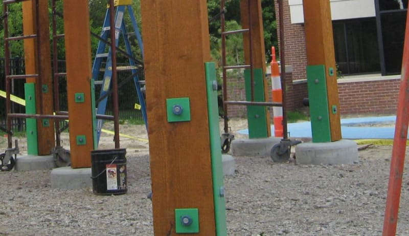

RE: Wood Screened Porch - 3 Season Room Lateral System
We've used a detail where we embed a large steel angle in a concrete pier or pedestal - fixed to the concrete with adequate headed studs and wrapped in a steel rebar cage.
The angle extends vertically out of the concrete for a distance (perhaps 3 ft) and is bolted to vertical wood columns. This forms a rigid base in which a cantilever column system can be developed.
