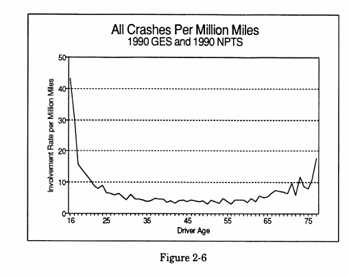

"Are accidents spread fairly evenly across the driver community, or are a few drivers responsible for most accidents?"
Accident rates per mile driven are biased highly towards new drivers (the stats are complex), young drivers, and old drivers. Men are about 50% more likely to crash than women.

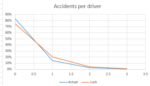

RE: Self Driving Uber Fatality
Yes, Brian but posting an analysis that shows how good good drivers are and how bad the bad drivers are doesn't really help, I think. Here's the best I could find, I don't know what the source data is, or even what is really being plotted, probably crashes of any type in the last year on the x axis, and the proportion of drivers on the y axis.
The Luck curve is if you just take the average crash rate (20.3%) and do the usual probability on it. Not a whole lot different to the underlying data.
Obviously many meat drivers never have an (injury/fatality) accident in their half a million miles of driving in their lifetime. So accident free meat drivers are a hard target to beat, since they have a perfect record.
So I'd rather look at averages.

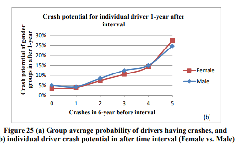

https://search.proquest.com/openview/5809c2c3cb007...
also has some interesting stuff
I like this graph. What it is saying is that if you have had 0 or 1 crashes in the previous 6 years, there is a 5% chance of having a crash in the next year. If you've had 5 crashes in the previous 6 years, there's a 25% chance you'll have another crash in the next year.

@dik, "Does this account for young drivers doing most of the driving?"
The first graph is per million miles so yes I think that it does account for the higher annual mileage of younger drivers.
