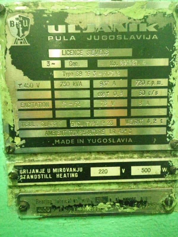

Dear All,
Please advice me,I have problem with my generator.the current excitation hunting around 2-7 A, I 'am already inject the exciter using 12 V battery and disconected source exciter from AVR but the voltage remains unstable
help me please

What is the load on the generator?
Is this set islanded or paralleled with other sources?
Is there a surge suppressor of some type on the rotating diode plate and have you checked or replaced it?
Did you megger both the stator and the rotor of the brushless exciter?
Does the current output of the main generator carry with the field excitation?
Does the kW output of the main generator vary with the excitation?
What size is this generator?
What type of prime mover?

RE: Current Excitation Unstable
Thanks Waross,
These my generator nameplat
Marine Generator Type,Varistor and Rotating dioda has not been replace because already check and good condition,
any 3 Unit Generator same type,parralel operation.
