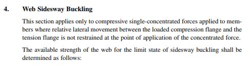

I am trying to clarify J10.4 in AISC - Web Sidesway Buckling. I might be a little picky here, but I want to make sure I understand this correctly.
AISC gives two different equations depending on whether or not the compression flange is restrained against rotation. Here is my confusion:
J10.4 -
"This section applies only to compressive single-concentrated forces applied to mem-
bers where relative lateral movement between the loaded compression flange and the
tension flange is not restrained at the point of application of the concentrated force."

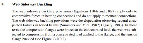

Comm J10.4
"The web sidesway buckling provisions (Equations J10-6 and J10-7) apply only to
compressive forces in bearing connections and do not apply to moment connections.
The web sidesway buckling provisions were developed after observing several unex-
pected failures in tested beams (Summers and Yura, 1982; Elgaaly, 1983). In those
tests, the compression flanges were braced at the concentrated load, the web was sub-
jected to compression from a concentrated load applied to the flange, and the tension
flange buckled (see Figure C-J10.2)."

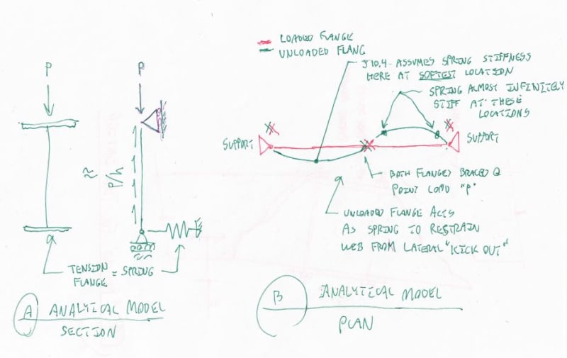

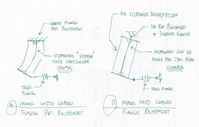

With love, I'm pretty sure that you're interpreting that bass ackwards. They're not saying that you should add more stiffeners when there is no rotational restraint at the loaded flange. Rather, they're saying that, sans rotational restraint to the loaded flange, stiffeners are utterly useless at any location and a zillion of them wouldn't make a lick of difference. In support of this I submit:

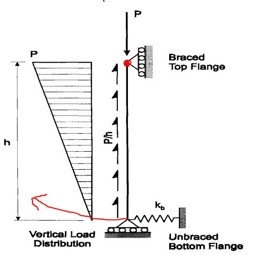

1) Last sentence of the AISC commentary blurb below. Note that I consider quoting the opinions of other people/organizations to be a relatively weak form or proof. Weak... but not quite nothing.
2) Sketch below showing the difference between the restrained and unrestrained cases highlighting why stiffeners are useless at any location when the rotational restraint to the loaded flange is absent.
@WARose: since we've both read the same papers, I assume that this is old hat to you. And I certainly don't want to condescend (at least not any more than usual). That said, I want to be sure that we're on the same page on this as there's not much basis for discussion here if we have any disagreement on this fundamental aspect of behavior. I also thought that the sketches might be of interest to any lurkers that might be following along.

I'll play my own devil's advocate for a moment and assume that sway buckling is possible at locations other than concentrated loads. Even at that, I know of two locations where it definitely won't happen:
1) Near the ends, assuming the usual condition of rotational restraint there and;
2) Near the concentrated load, assuming rotational restraint there.
The reason for this is that the "spring" bracing the edge of the web opposite the load is really just the unloaded flange acting as a simple span girt. The consequence of that being that our spring is wickedly stiff near both the supports and the concentrated loads. So if "in the field" sway buckling is a thing, then it must really be occurring in the field, far away from supports and concentrated loads. I'll get into the field condition next.
Another point of interest here is that our code checks only address a single concentrated load occurring at mid-span. For single loads occurring at other locations, the checks would be conservative. For multiple loads, all relying on the same unloaded flange as the bracing "spring", the checks would be unconservative unless thoughtfully adapted to that situation.

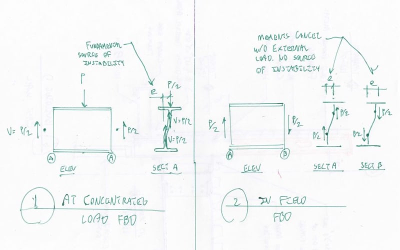

Regardless of what we or AISC have to say about things, I don't feel that there's any real "there" there unless it can be expressed as a valid free body diagram. Consequently, below, I've shown:
1) The case at a concentrated load, indicating a valid source of instability.
2) The case away from any concentrated loads, indicating the lack of a valid source of instability.
So I throw down this gauntlet as a challenge to those advocating sway buckling in the field: FBD it.
I say no external load = no sway buckling. The only non-local instability in the field that I see is wholesale rotation of the section about a point in space centered over the non-distorted web. And that's LTB which is another animal altogether.
RE: Steel Beam Bearing - ASIC J10.4 Web Sidesway Buckling

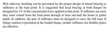

Note that, in the commentary blurb above, they specifically exclude moment connections from consideration. Why? I contend that it's because a moment connection will deliver a tension force to the connection offsetting the destabilizing effect of the accompanying compression force. The net effect is that you end up with essentially the "#2 field" case that I showed above. No net external load = no sway buckling. One may want to rethink this "out" if you were attempting something silly like carrying a W36 column with a W6 beam.

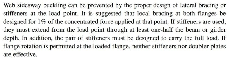

This blurb, also from the commentary, also provides some fodder. They make a special point of saying that the stiffeners must be designed to carry the full load. Why? Presumably the web has already passed yielding and crippling checks so the stiffeners aren't needed to carry the load, only to laterally stabilize the unloaded flange, right? Wrong. I contend that this statement was included because of this:
Quote (KootK)
When you have only internal shear and no nearby external load, all of the forces at a given cross section move along with the cross section and there's no eccentricity or P-delta induced.
I believe that the stiffeners must carry the full load so that one can plausibly claim that, away from the stiffeners, all load is carried via beam shear and none is carried via residual, destabilizing web compression. Of course there will always be some web compression owning to compatibility but, as always, we do the best we can with what we've got at hand.

How is that possible though? If you added a "zillion" of them (say one every few inches) you don't have the same beam anymore. In fact sidesway web buckling should be completely precluded.
I think a far more likely explanation for J10.4.b. being worded that way is: to instruct someone as to when/where/how often to add those stiffeners would overly complicate things and wouldn't be practical. It is probably better in such a situation to just go back to the drawing board and cut down on the unbraced length.
Now, regarding your pic "B" in your reply of 31 Mar 18 20:08.......you say that "the stiffeners just go along for the ride-useless". Again: if this theoretical beam had a pile of stiffeners every few inches......how could it buckle at all from sidesway like that? Any buckling seen would be from another mode. (I.e. LTB, etc.) You would essentially have a HSS with a lot of holes in the side.....the web couldn't buckle from sidesway.
As I see it, "web sway bucking" is any form of relative lateral displacement between flanges resulting from a local, column like instability in the web. That would consist of:
1) The S-shaped web distortion that we generally like to visualize/test.
2) Straight up rotation of the beam as a rigid cross section (sketch below).
Number two, of course, is not prevented by stiffeners, tightly spaced or otherwise. In support of this conception of sway buckling, consider that the code capacity of the member for the unrestrained case doesn't actually depend on t_w. I believe that is because web distortion, and thus stiffener involvement, is not a factor in the unrestrained case.
Quote (WARose)
Yeah, since both LTB and sway may produce a roll in the member, the waters get muddied some with respect to our observations and conceptual visualizations of the outcome. LTB, constrained axis LTB, and web sway buckling surely start to overlap with regard to look and feel and may only be distinguishable based on the different origins of instability for the various modes.
Quote:
(Kootk)
Actually it does (at least in the 13th edition). Equations J10-6 (i.e. compression flange restrained against rotation) and J10-7 (i.e. compression flange not restrained against rotation) both have web thickness as a variable.
Quote:
(Kootk)
To my mind, it's just about absolutely impossible for the web to buckle (in sidesway) with a large number of stiffeners present. If the minimal forces required to restrain the beam at the point of application were present at the ends (and the beam had any rotational stiffness at all)....it just shouldn't happen. I think J10.4.b is worded that way because there is no point in doing a research project for a beam design. For all practical purposes.....it's time to pick a new size if you run into this. (Rather than placing a pile of stiffeners.)
Quote (WARose)
Actually it doesn't. Gotta bust out a little 8th grade algebra to drill down to the truth of it.
It drives me a little nuts the way that AISC does this sometimes. They do a bunch of unnecessary algebraic manipulation to make the equations look "consistent" and, in the process, confuse the heck out everybody with regard to the true nature of the expressions. Jury rigging things to include variables that aren't even legit parameters... Timoshenko would not be impressed.
