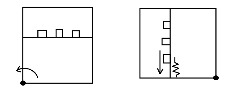

I've seen a similar problem come up several times through the years. Basically, I'm going to drop Item X on a hard surface, and what's the force generated. Well, you can do the F=ma and all of that, but you can't solve the problem without detailed analysis of deformations in the object and in the surface it's hitting, which is usually impractical, and in many cases, impossible. You can assume the distance that it decelerates in, or assume the time it takes to decelerate, but then again, you could assume the force and save some effort.
One approach- see the diagram below- I'm showing widgets attached to a shelf in the cabinet. Assuming the cabinet tips over, hopefully, you can calculate the velocity when it hits. If you have any way of calculating the spring coefficient for that shelf, and know the mass of the widget, you can work it out from there. If the shelf is "heavy" relative to the widget, you're left assuming some portion of the shelf weight in that mass as well. Still very approximate, all in all, though.
