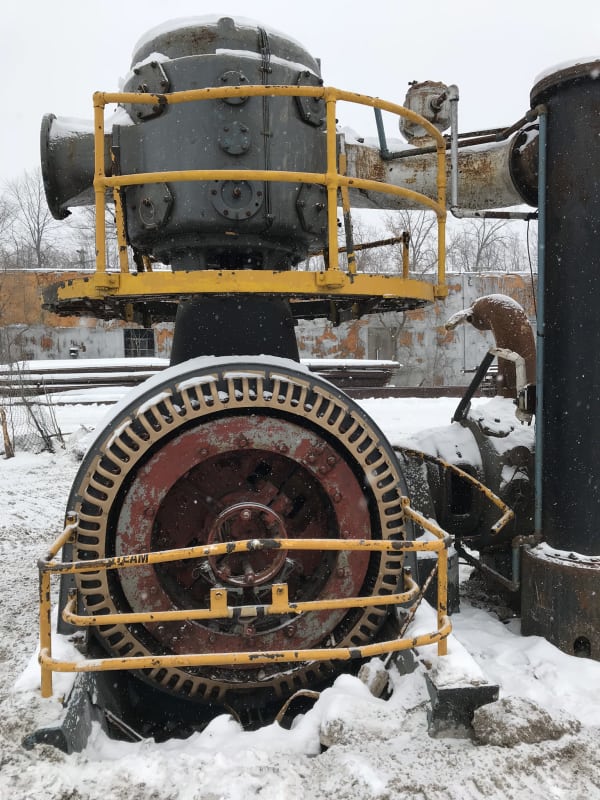

This is the motor.
RE: Historical Westinghouse Motor Information
My guesstimate is 7 to 8 tons.
Off the topic - An open type motor in that environment? The end user is brave indeed.
Muthu
www.edison.co.in
I don't think that the motor/compressor was used in that environment.
That looks like the boneyard.
With the integral compressor and connected vessel I would guess up to as high as 15 tons.
