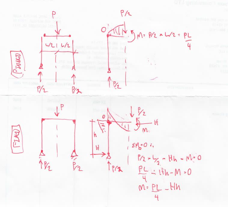

I think that I see what you're getting at. For illustration purposes, consider a frame consisting of one beam, two supporting columns, and a vertical point load at beam mid-span. We'll look at it with both pinned and fully fixed beam to column connections.
- Conservation of vertical forces for both systems is apparent with respect to beam shears, column axial loads, and column base reactions.
- There is an eccentricity created by the offset between where the load is applied and where the load is ultimately resisted at the column bases. The moment that this eccentricity creates is conserved in both cases. It redistributes for different degrees of beam/column connection fixity, but is still conserved.
- Your case lies between these two extremes but the same logic still applies. Bending moment may redistribute from member to member, including connection elements, but it will remain conserved in the aggregate.
