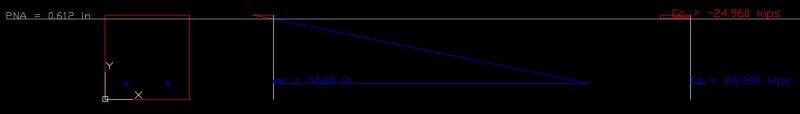

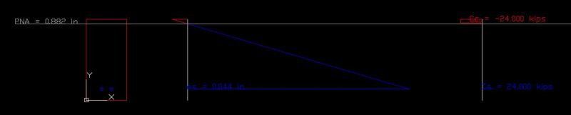

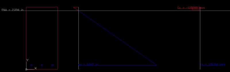

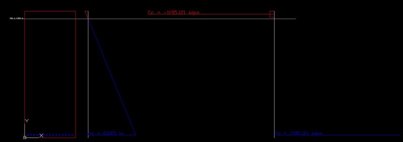

I ran a bunch of different beam configurations and pretty much was always ending up with strains in the 0.0x to 0.00x range so well under the 0.1x range for rupture on diagrams I was finding. It was seeming that the minimum steel ratios and standard equations where set up to pretty much guaranty the steel isn't getting close to the rupture strain when the concrete reaches its rupture strain of 0.003-0.0035 but is hovering around the 0.038 to 0.045 range. See some examples below all with min steel and f'c of 5,000: 8x8, 12x12, 8x16, 12x24, 18x36, 12x120, 48x120
those images got horribly compressed - attached zipfile has the uncompressed images where you can read the numbers.

Have a look at stress-strain diagram. Depending on the code, around 2%

@Celt83, Excellent! Thanks for the response. I figured that the minimum reinforcement equations would typically limit the steel from developing too much strain, but couldn't find any solid data.

that is for single reinforced once you start getting into compression bars in the bigger beams you start getting into higher steel strains. Which makes sense as compression steel will reduce the pna depth increasing the distance from the pna to the extreme tensions steel and since es and ec are proportioned based on their distance from the NA the strain in the steel starts exceeding the 0.045 singly reinforced number. The larger your depth and reinf. ratio is the higher the delta in the pna location with the addition of compression steel.
Skin reinforcement starts coming into play though which included or not in anaylsis can greatly impact the steel centroids and help rein that extreme strain back in, although at the expense of shear strength when considered.
