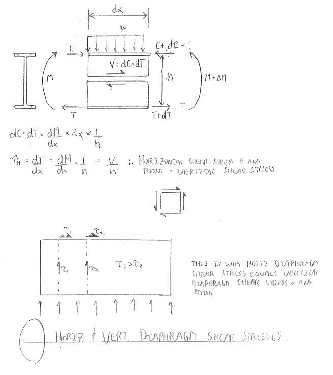

What you're missing in your sketch is the fact that, in that situation, it's is shear parallel to the roof ridge that gives us grief. Just like in mech 'o materials class with those little infinitesimal element squares and shear of a necessarily complementary nature.

Would love to but I've already posted a custom sketch today and one's my self imposed limit. That whole family feeding thing. The sketch below is related and from when I was trying to convince myself of similar things long ago. Might help.
Quote (OP)
I thought the FBD on the left of my sketch suffices to demonstrate my point of not worrying about the little gap at the ridge (due to ridge vent).
I doubt that anybody every was worried about the little gap that you've addressed, in the sense that you've addressed it. That's just run of the mill drag strut/collector business. The concern that you referenced in the other thread was always all about shear parallel to the ridge.
Quote (0P)
Is it the unit shear (parallel to the ridge, at or close to roof peak) in "wind perpendicular to ridge" load case your concern?
Yesir. Primary concern at least.
Quote (OP)
If that the case, the concerned unit shear would equal V/(building length)? and if the building length is not significant shorter than "W", then it should not of a concern.
I believe this to be incorrect. Horizontal shear equals vertical shear at all locations. It's that whole complementary shear stress business that I mentioned before: Link. My sketch should also help with this.

Why would you think otherwise? Per my derivation above, it's based on nothing more than the requirement of equilibrium. Note also that, when we design wood and steel deck diaphragm fastenings, we always design for the same shear in both directions. Your side lap and support fastenings go together as a matching pair. This is why.

Just because the horizontal shears (perp to load) don't directly load the resisting shear walls doesn't mean that they don't exist within the diaphragm. This is one of the reasons that we have diaphragm chords: to balance the horizontal shears at the diaphragm edge where there may not be shear walls running parallel to that edge.
Besides, if these horizontal shears don't exist in flexible diaphragms, then how do you develop axial forces in your chords?

It's important to recognize that that formula is not the unit shear. It's the total shear divided by the half span which is different. At least that's the case in the elastic domain which is where diaphragm design usually resides.
I haven't compared my shear flow method to anything else because, frankly, I don't think that there is anything else. It's just:
- Unit shear parallel to load = shear / building width.
- At any location, shear perp to load = shear parallel to load.
