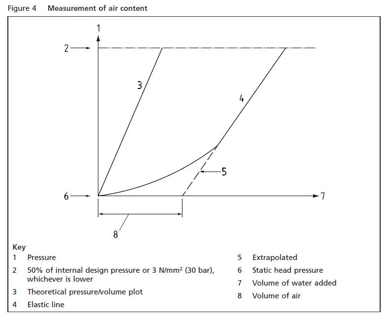

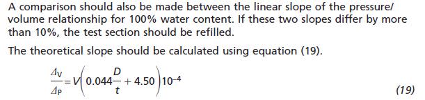

Try and get a copy of BS PD 8010-1. Section 11.6.5
The air volume is found either by plotting pressure rise vs volume and then tracking back to zero pressure based on a straight line. Or plotting the pressurisation line and seeing how far out you are.
Air is 80% nitrogen....

LI tell us more about D,t and the units used in eq. 19.
