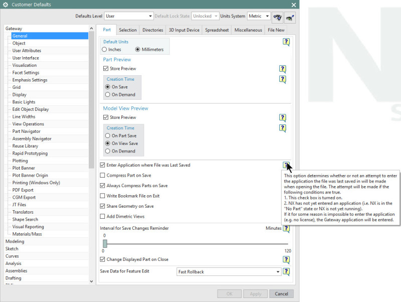

RE: vb journal to open non master part
You can set a customer default to open the part according to the last "saved" actif module (modeling, drafting, cam...)

Hi Ehaviv,
OK, but it's so simple with this setting in Customer default
Regards
Thank you Didier.
The problem was arise to me in a journal
that need to open a non master drawing
that should be run regardless of the
setting on the customers default.
I can't know the setting of each user.
