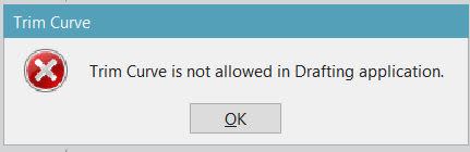

I just learned Trim Curve is no longer able to be used in Drafting. Not that I used it a lot, but there had been times when it came in very handy because you could trim multiple curves to the same boundary line. Now the only way I see to trim a curve in drafting is to double click the line and trim to select. Which only will work on one line at a time.
Am I missing something here? Is there another way to trim multiple lines to the same boundary now, or did they get rid of the only way and make us have to do a job one curve at a time?

You can't even customize the dialog and use the Trim Curve option
You can create a sketch in drafting now and use the quick trim and quick extend tools in the sketch to quickly edit curves on a drawing
Yes, Sometimes I wish the old trim curve and basic curve options were still available (just old habits for me)
Edit - you can add the Basic Curve dialog to drafting - Thanks Tim!

Open the old reliable Basic Curves dialog - the original Trim Curve still exists there and can be used in both Modeling and Drafting in case you don't like the "improved" Trim Curve where you have to specify the Keep and Discard areas.

Yes it looks like the Trim Curve still works in the Basic Curves. Good to know. Thanks for that.
