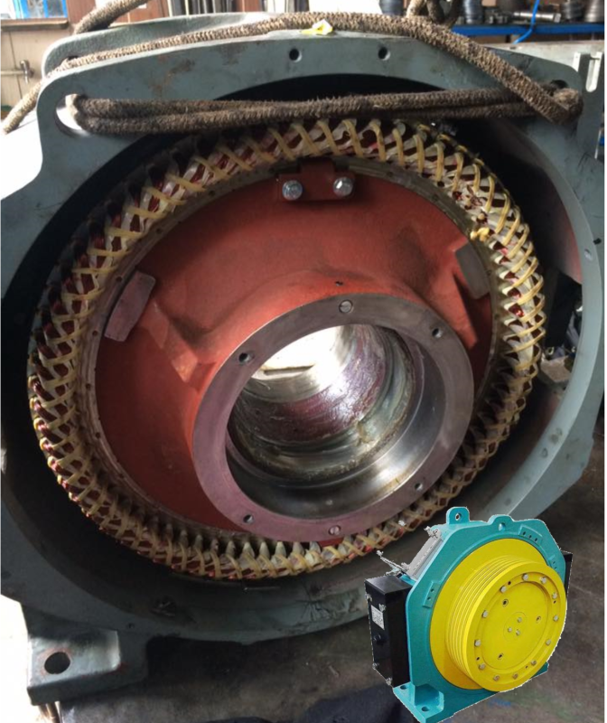

Probably it is about low speed PM motor (usually elevator motor, see the picture below).
Number of poles is depending on Hz applied.

zlatkodo - I think you nailed it.
