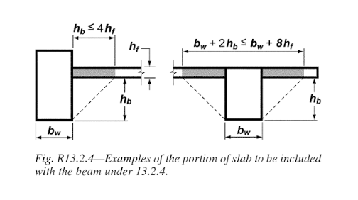

Just an fyi ACI 13.2.4 provides secondary requirements for beams in two-way slab systems, see this criteria get missed a lot.

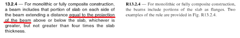

I have looked up what Celt83 posted.
I dont really know what is meant by projection - can someone explain?
RE: designing a RC beam partly integrated in a slab
found it:
