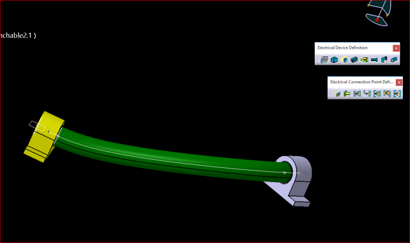

RE: CATIA ELECTRICAL HARNESS QUESTION
How about these two tools:
What are they used for?
CAD 2015
Those toolbars are used to electrify connectors, backshells and so on.
