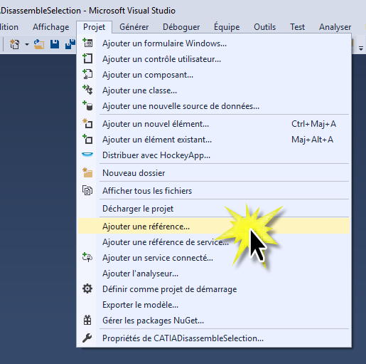

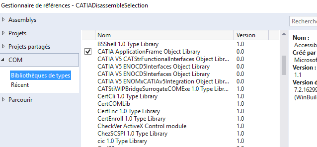

RE: Create View (vb.net) using example from doc
did you reference the (usual suspects) CATIA libraries in your VB project references?
I suggest you check in CATIA VBA wwhich libraries your need...
Eric N.
Actually I'm not sure :) I usually use same solution and I don't remember if I done this a really long time ago, or if I didn't do it at all.
I will check this and provide feedback.
I suppose I should add and use always all necessary references but I got used without them :(
Thank you for the answer.
Nope, I don't think the references are the issues.
I have added below references, but still does not work:
CV5 ApplicationFrame Obj Lib
CV5 Interfaces Obj Lib
CV5 MecModInterfaces Obj Lib
CV5 Product structureInterfaces Obj Lib
CV5 DraftingInterfaces Obj Lib.
I am starting to think that it is not possible to create a view in vb.net :(
Any ideas?
In the end I have added the necessary references, I had imported them and I have declared everything.
Now it works.
