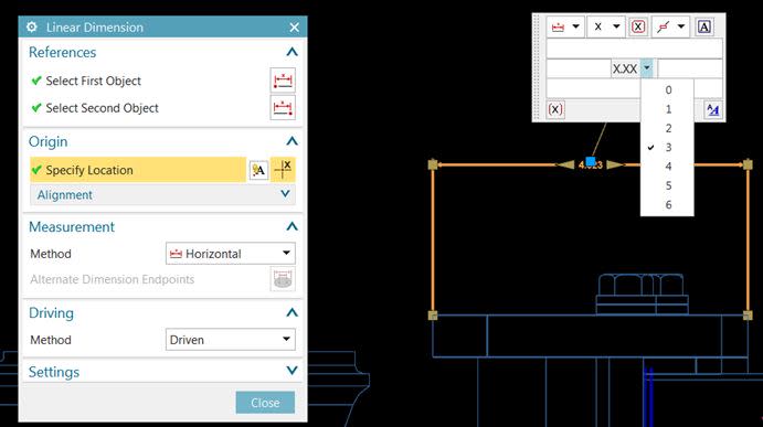

How do I change the number of places behind the decimal by simply double clicking the dimension and pressing the number of places I want on the keypad? This used to be a really nice feature but has been removed.

How do I change the number of places behind the decimal by simply double clicking the dimension and pressing the number of places I want on the keypad? This used to be a really nice feature but has been removed. Use ALT+2 ALT+4 ect.
When you double click on a dimension you should get a pop-up to change, among other things, the number of decimal places

@joycejo At the point where the box is at in your image all you have to do is hit the ALT+6 or ALT+2 to get the decimal places. It was just like it was in the old Version of NX but you have to use the ALT+(number of decimal Places). They had to make it an accelerator key vs the old 1 thru 6 due to the new Dimensions layout
