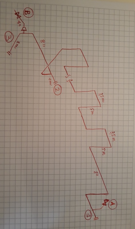

Here is a simplified sketch. line is from Valve A to Valve B. Spare connections (1,2,3) of about 1 metre each, blind flanged

That's a bit unfortunate.
However you could still use a sphere and also insert a gas connection at point B if you can.
If you can't drain down then you are a bit stuffed really in terms of getting anything in to clear it out.
You said the expansion loops were vertical but you've shown them horizontal?
What is elevation of the various bits?

by pigging with spheres, don't they end up in the spare connections 1,2,3?
Littleinch, expansions loops are vertical..rotate the picture to left..
