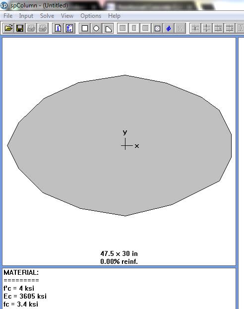

I'm designing some bridge piers (to Eurocodes) which are to be elliptical in section and am having difficulty finding a reference or design guide as to the best way to assess them. Has anyone undertaken a design of this nature before and would have any suggestions? The piers are subject to bending and axial loading.
(I have already attempted to design them as circular columns inside an elliptical section but they are insufficient to withstand my loads).

The section is 1.746m by 0.946m, 5.3m tall. Axial load is 11866kN with bending at the top of the pier of 6265kNm and at the bottom 4377kNm.

Does the column work as a circular column with a diameter equal to the minor diameter of the ellipse? Doe the column work as a rectangular column inscribed within the ellipse... else you have to do some detailed calculations for an interaction diagram... can check max compression value, balanced value and max flexural value to give you a 3 point interaction diagram.

dik has some good advice above. When faced with a irregular column shape in the past (I use to do a lot of architectural work), I'd draw a crude/conservative, lower bound interaction diagram (i.e. consisting of 2 straight lines connecting 3 points (max. P, pure max. bending capacity, and tensile strength based on vertical re-bar capacity)).

spColumn from Structurepoint can do column designs with "irregular" cross sections - including ellipticals.
Here's a link to their website: spColumn
I quickly free-handed a rough shape - you could probably do way better than this for sure. It also works in non-English units:

Thanks for the input, yes a simplified interaction diagram is the way I'm leaning. Just a lot of iterations/variables when working with an ellipse. A lesser section within the ellipse is not large enough unfortunately.
Jae - I'm currently waiting to get SP installed on my machine at work so once I do I'll be able to make a comparison hopefully.

You could also go really back-to-basics and do a spreadsheet considering the cross-section as a series of horizontal strips, with a small height to capture strain variation and a width calculated to match your elliptical shape. Rebar would be a set of points. You could iteratively solve for neutral axis depth then use strain compatibility to get the force in each strip and rebar, then integrate to get a moment capacity. If you were including axial load as well, you'd have to consider that in your solution.
Ideally you'll be able to find an appropriate program to do the calculation and/or some literature to back it up. But don't forget there's a first-principles way to handle it too.
EDIT: note also, this is the way programs like spColumn, S-Concrete, etc., are doing the calculation too - some of them will actually output the strip-by-strip calculations.

ChadV I built a spreadsheet to work out the force and moment equilibrium in the section for a given neutral axis depth. I used this then to generate an interaction diagram, I've attached a couple of screenshots. This in a way, is what you're suggesting? As you rightly point out it's technically integration but in a more literal sense!
Thanks avscorreia, I got SBeton installed and ran a similar assessment, it confirms that the section capacity is sufficient, corroborating my spreadsheet. I've allowed for some bending about the Z axis which has bumped up my steel quantity. On a side note, when you first ran/installed SBeton was it giving you "an unexpected network error" warning? It will not allow me import from dxf or save the file. Apparently I need to dive into the .cfg file and alter the JIT settings. Just wondering if it's a global issue or just something on my machine.
