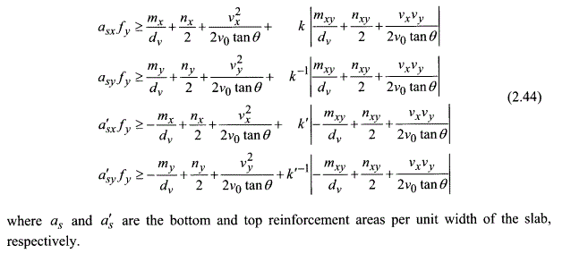

The sandwich model for shell elements from the FIB Model Code is one way of dealing with this situation. Handles all stress resultants from an analysis including in/out-of plane shear and twisting moments (if you have them; might not if using hand methods).

The sandwich model is in section 7.3.2.2 of Model Code 2010, but it doesn't give the detailed explanation that I thought it did (there's a step missing that's a bit hard to work out just from the Model Code). I was actually thinking of FIB Bulletin 45 "Practitioners' Guide to Finite Element Modelling of Reinforced Concrete Structures" sections 2.3.5 to 2.3.8 which include a worked example.
The sandwich model gives a method of resolving the eight stresses that a finite element shell analysis gives as results into numbers that can be used for design of reinforcement and checking of the concrete strength. After applying the sandwich model, you get four in-plane forces for reinforcement design (top x-direction; top y-direction; bottom x-direction; bottom y-direction) as well as the principal out-of-plane shear force. You can then use your own concrete code's provisions (eg ACI) to design the reinforcement/check shear/check concrete compressive strength.
In-plane shear is rolled into the equations of the sandwich model so you won't design for it directly. It appears in the equation for reinforcement area in all four layers.
Torsion 'dk' is the diameter of the circle that might be inscribed at the most narrow part of the cross-section (Model Code 2010 Figure 7.3-18). You don't need the torsion rules for shell/sandwich model design and I've never come across 'dk' before to be honest.

How do you design shell for torsion?In the sandwich model nxy=nxy/2+Mxy/dv
But the problem is that if we take the whole cross section of a shell in addition to the moments mxy on the section the out of plane shear create an additional torsion moment about the center of the section.so how do I take that into account?designing for nxy given is not enough.
And could I use nxy in another code (aci)?thank you

I'm assuming you're trying to design for the output from a finite element analysis. I'd prefer one set of numbers per element (ie averaged) and this is usually adequate for design (provided the mesh was fine enough for analysis). It wouldn't matter though if you had four sets of numbers per element, just more post-processing.
I'd take the numbers output from the FE analysis (Nx, Ny, Nxy, Mx, My, Mxy, Vx, Vy) and feed them directly into the sandwich model equations (image below) without modification. By doing this, the eight stress outputs listed above are converted to four equivalent/effective in-plane forces to be resisted by the reinforcement (top x-direction; top y-direction; bottom x-direction; bottom y-direction). These effective in-plane forces include the effects of in-plane shear Nxy and twisting moment Mxy. There is no need for torsion rules to be used: you just apply reinforcement area multiplied by design reinforcement strength.
You then check out-of-plane shear and concrete compression strength separately. The concrete compression strength check accounts for the components of shear forces that can't be resisted by the reinforcement.
