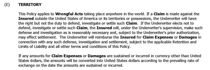

I just looked up my policy from last year from One Beacon (which is not longer offering coverage for engineers): They say that they cover your settlement and loss overseas but you have to arrange for your own defense.
RE: E+O insurance for overseas projects
I looked at a half dozen policies that had been proposed to me over the years and none of them have that language or anything like it. I wonder what question you asked the agent (that I obviously failed to ask) that got you a policy with coverage outside the U.S.? I also wonder what the premium was for that policy?
The premium for this Beacon policy was $14k for my two man practice.
As I am looking into it some more, the carrier Admiral seems to offer similar terms in respect to territory.
You are in a little different business - I am in the Architects and Engineers space (i.e. construction) and you are in maybe mining or something. I know that carriers get very exercised about which "market" it is because its so regulated.
