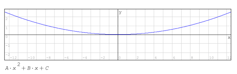

Thanks again... looking at solving a parabola through 3 points using a the solution of a quadratic and determining the coefficients using a 3x3 matrix solution. Looks like they typically use a 2'offset to PI and keep it at the same elevation as the support centre line Using SMath Studio. Have another problem to do first.

It allows the calculation of the support heights between points of inflection within the span and if the equivalent points are determined for end span, and 'wierd' conditions, it will not give an exact solution, but somewhat close. Also at supports, if the strand is not horizontal between points of inflection, an approximate parabola can be developed for this condition.
There will be a cusp at the points of inflection due to the parabolas not having the same slope...I think due to the stiffness of the strand, this would give an approximate solution.
First kick at the cat... from grade 11 or 12 math of 50 years ago... not too shabby.
