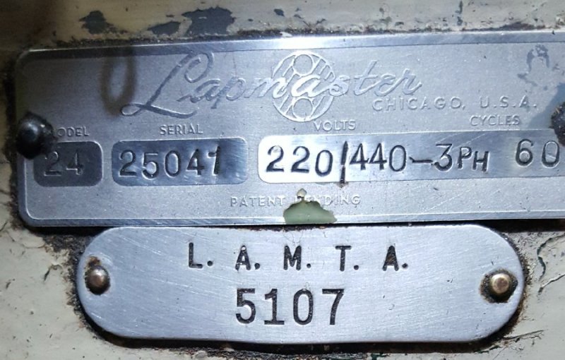

I got the 60 from the owner pointing at it and insisting it meant "1960". Seeing the voltage and 3ph on the line I told him, "Naw, it's 60Hz". He insisted the seller said it was "circa 1960" and that's what it meant. I couldn't see it very well since it was almost 2 feet over my head on a fork lift. Now that I decided to toss it in to show you guys it's "1960" I see very clearly that the stamped label is, of course, showing "CYCLES" LOL

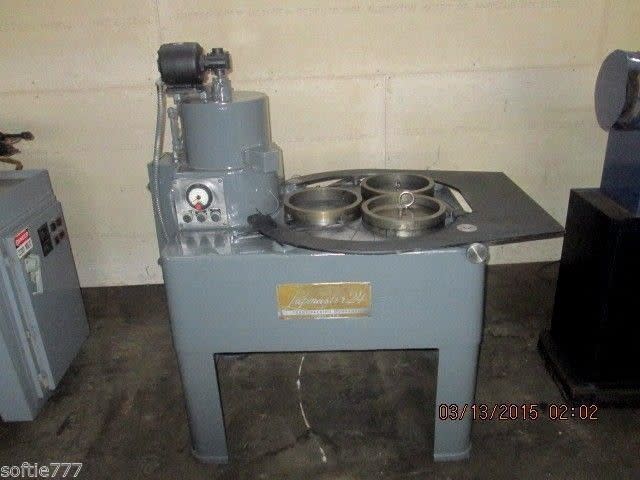

This is what the machine looks like:
Yeah... 1960s? No.. When did cast-iron legs go out of vogue?
