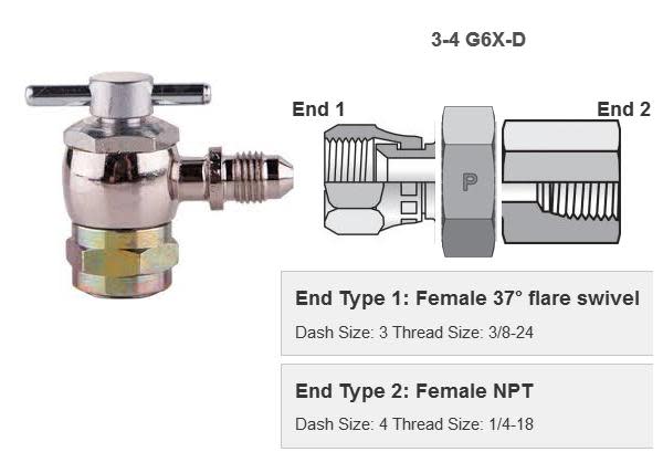

Let me try to provide the short story.
I wanted a tire inflator valve with a "no Loss" air chuck. My google hits found the valve I wanted and Pic showed it having a NPT connection. This just happen to be through WalMart's marketplace provider.
However, the chuck I received has a "3/16 tubing" connection. the reply to email to ask for exchange came back that is all they have and gave me a full refund. so I am out nothing and have the chuck.
first thought was I should be able to find a fitting so I could use it, BUT I cannot find the 3/16 (-3) fitting.
So I was hoping maybe someone that has dealt with fittings more than I would know where to find ONE. The fitting's cost must be < $6, before I spend $45 to have one made, I'll just go to another vendor and get the chuck with NPT

I had search Grainger and several other sites. the other two posted were ones I hadn't search prior, but getting similair findings. the -2 and -4 JIC are available and some were even cheap. So far the -3 (to a NPT thread) has eluded
What looks like a doable alternative is hose end fittings, so making a 12" whip would work. online pricing though has it about $20 just for pieces. BUT possibly something the local tractor shops could make for me

Are you sure that that is a 37deg flare?
It looks like a 1/4" x 45 deg fitting.

Try here, http://fittingsandadapters.com/tubredfemjic.html and look at part number 892-3-4, this will adapt your -3 JIC male fitting to a -4 JIC male, easier to find connectors for.
You can also try your local CAT dealer, this same tire chuck is used in their nitrogen tire charging kit, I don't have a parts guide for it anymore, but someone in their parts department should be able to help.
Hope that helps, MikeL.
