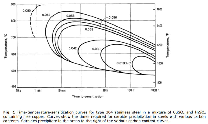

There is vessel with hydrogen service with material of sa 516 70 normalized with thickness more than 50 mm. We have 3mm clad of SS 304L (carbon content less than 0.02%).
It seems that heat treatment is necessary due to thickness and service. Vendor wants to use furnace for pwht. Our small nozzles(2 inches) are solid stainless. The question is that these nozzles must be welded before furnace or vessel must go to furnace without these nozzles and shall be locally pwht after furnace?in this case doesn't we have two times stress releiving which can make more probability for senthisizing?

I would suggest for the small nozzles to have the weld prep ends on the vessel where the nozzles will be attached by welding buttered with Inconel 82 or 182, PWHT the vessel and then install the solid nozzles on the butter layer weld preps using Inconel filler with no PWHT required.

I would also suggest to go with Incoloy buttering and weld the 304L nozzle after PWHT. For hydrogen service you should go with full penetration welds. Performing PWHT with the nozzles welded should be prevented since your vessel will be subject to temperatures of about 600-700°C for some hours during PWHT and preticipates may form in the 304L (=sensitization) even if the carbon content is very low.
I've made good experience with buttering and PWHT as long as the buttering is big enough in size and thickness for further welding so that should be taken care of and checked in the PQR.

The 304L SS clad itself would be exposed to the PWHT of the CS part.
The OP mentioned that the clad has 0.02% carbon content, lower than the 0.03% carbon specified for 304L grade. So sensitization is no longer expected to the cladding?
The solid SS nozzle is also 304L grade. Can I ask if you expect sensitization to the solid SS nozzle, even if it is low carbon grade, why would the clad itself be exempted? Or is it ok for that to happen to the cladding? TIA.

The 0.02%C low carbon content of the 304L clad will help regarding severity of sensitization, but it will still occur. This is why corrosion testing is performed on occasion to determine if the clad material will have corrosion issues in service after fabrication (e.g., PWHT of the vessel).
