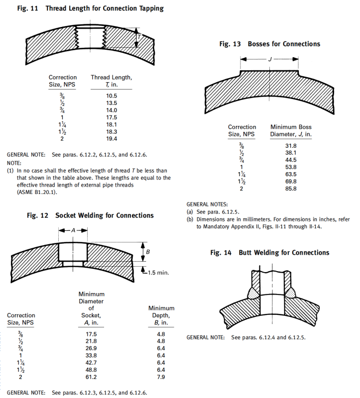

see table label and units of measure - "Correction" and "in.". i'm thinking connection and mm.

It's surely a typo. The same tables are found in ASME B16.34 Fig 2 and Fig 3. Dimensions are in mm.

um, the 2003 & 2009 editions are aok.
i guess the change to metric led to some oversights/errors.
keep your eyes open . . .
