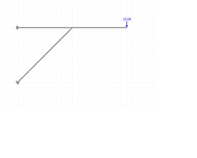

I have what may be a simple question. I'm looking at designing some triangular frame for some pipe support. Could anybody suggesting how to calculate the bending moment at each member and reaction force at fixed support? I have been using different online calculator, but each of them gives different results.
The support may take the following shape,
Is there a simple formula for estimating the bending moment and reaction force?

I would treat each connection as pinned and then this is just simple statics.

If the connections are truly fixed, as shown in your diagram, then the structure is indeterminate and I suggest using a structural analysis program.
If the connections are pinned, it can be solved using statics. There will be a downward reaction of 10 kN at the upper support, and a diagonal reaction of 28.3 kN at the lower support.

Dave, do you mean an upward reaction at the upper support? it will try to rotate around the diagonal brace.
Let's say each square is 100mm, the maximum moment in the horizontal member will be 10kNm based on the diagonal providing vertical support.
The horizontal tension reaction at the upper support would be 20kN (10kN*2m/1m). Therefore the horizontal compression reaction at the lower support would also be 20kN (therefore the 28.3 kN compression in the diagonal brace). This would all result in a 10kN uplift at the upper support summing the forces in the vertical direction.
Again, assuming it is all pinned. If fixed, then we cannot determine the forces without significantly more analysis.

It will be a downward reaction at the upper support, since the horizontal member is trying to rotate around the diagonal brace.

I'm going to assume we're talking the same thing, one from the side of the beam, and one from the support. To me I would call the connection of the upper beam subjected to an uplift type reaction at the "wall".

I would like to ask is there is a way to calculate the bending moment? I am selecting steel section for a pipe support and he decision is mainly based on bending moment rather than the axial stress, since section has a much lower bending capacity than the tension/compression capacity. But if all joints are assume to be pinned joint, then the diagonal member would bear no bending. Isn't it not close enough to the real case, which all beams are weld together and moment can be translate though joints? Is there a way to make a rough estimation, or a rule of thumb to make a safe approximation?
There is another concern. If the diagonal is not 45 degree inclined, would it affect the distribution of loading? Should I assume the diagonal section would have a compression of 20/cosθ and find the vertical force in supports accordingly?

As jayrod12 said in his first post, treat the connections as pinned, and it is simple statics. You don't need a computer program for that.
