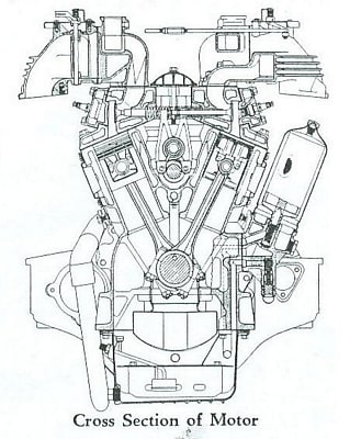

Old combustion chamber design which is new to me. What are the tradeoffs?

The Lycoming "BB" V-12 was designed in 1932 by Auburn's Chief Engineer, George Kublin. Lycoming invested over $1-million in the new engine: $400,000.00 in designing, engineering, and development; and $600,000.00 in new machinery, tools, dies, buildings, and all other manufacturing-related requirements. The Great Depression killed off luxury sales, so the V12 was sold to American LaFrance for use in fire engines. There, it lived on another thirty years.
I've been building engines for fifty years, but when this one came in the door, it was new to me. What were the pros/cons to a pocket combustion chamber such as this?

RE: Old combustion chamber design which is new to me. What are the tradeoffs?
Looks to me like a ton of surface area for heat loss, and a bizarre assembly sequence with a lot of extra parts. Looks like the valves have to go in through the extra bolt-on piece that goes on the side of the combustion chamber.
If you're going to have rocker arms, you might as well put them on top of the head and point the valves down into the cylinder.
I suppose it's not subject to dropped valves or catastrophic failures of the cam timing system.
Looks like intake and exhaust both have to do a 180 degree turn between the port and the manifold.

Yes, to all the above, but it's hell for squish.
I see almost no advantage to this configuration. It has very high volume-to-surface-area before expansion, and flame paths are all extremely long.
This reads to me as a product of an era where things like combustion chamber design were based heavily on guesswork- not a design you'd want to crib from.

Looks like an early version of pre-chamber combustion, just a bit more complex.
Agree, mostly. The flame path is reasonably compact compared to flatheads of the same era.
I found a spec sheet and the compression is only 7.5:1.

A flat head with over head valves. Like many designs of those times, someone thought they had a great idea, maybe it would have done okay on the low octane gas in those days, they should have bumped up the Cr a bit, maybe it wasn't so knock sensitive. Sure looks like nice induction and exhaust restrictions though. So Packard you got to play with one of those? It would or will be interesting to hear how it runs, please keep us posted.
