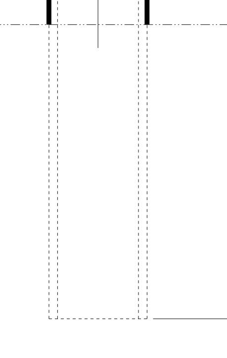

I've never been a big fan of the Guardrail embedment detail for exterior applications. This is in a normal climate (some freeze/thaw, but not excessive). It is hot-dipped galvanized railing that is about 5 or 6 years old, embedded 5" into concrete below and grouted. I don't have the specs on what grout was used, but clearly this isn't working...anyone had success on a retrofit without replacement?
I'm thinking about having them chip out the grout, clean the steel and replace with an epoxy grout that isn't as permeable, then put a rain cover type piece over that to shed water...I don't like that much either, but it could be a temporary bandaid

Is the bottom capped so that water can be trapped? there should be provision in the detail to prevent a void space there should also be a hole at the bottom to drain water... Even a 1/4" hole can be used to flow in flowable grout. I've heard that water expands with a force of 2000 psi...

The bottom does not appear to be capped. Appears open, see below from shop drawing...I don't have original design documents showing designer's intent, just shops.

Guastavino....even if you could chip out and replace the grout, you have section loss from corrosion in the posts. These should be fully replaced or sleeved and welded at the bottom and extend several inches above the grout line. After sleeving, corrosion protection will have to be done, but will likely not be as good as the original hot-dipped galvanizing.

You can introduce a small 1/4" dia hole about 2" above the surface and can use this hole to fill the embedded part of the pipe with a flowable or non shrink grout. This will prevent water from freezing in the lower part and expanding. Have done that numerous times... same with exterior HSS columns... even if there is no chance for water to get in.
