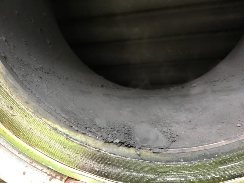

One question:
Has anyone experienced on the water side, a black oily substance? It was not on the pipes, but it was all over the shell. I have seen this in other old heat exchangers as well.

A photograph would have been helpful! Iron sulphide is a possibility.

It's on the water side, is black, oily, and you can smear it around...

what is the composition of the black deposit ?
RE: Heat exchanger H2S CO2 corrosion
Talk to whoever does your water treatment.
Have seen hydrocarbon leak into condensate return, which ends up in the feedwater. Can make for some nasty deposits.

You have to study the upstream processes for both shell and tube side to come up with an accurate failure analysis.
The one that you have done earlier is surely incomplete.
As a preliminary step, send the black deposits to the lab and test for sulphide, iron and even for hydro-carbons.

Unfortunately analysis of the black oily residue was not possible. The tubes looked pretty scale free, though.
