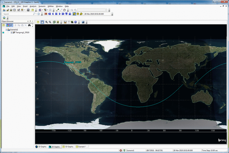

In case anyone is curious, here's the output from STK for one orbit of TianGong-1. STK is absolutely free for doing this sort of thing right out of the box. You can pay to do more, but it's pretty awesome as a free tool. Much more fun that some other programs that are free.
