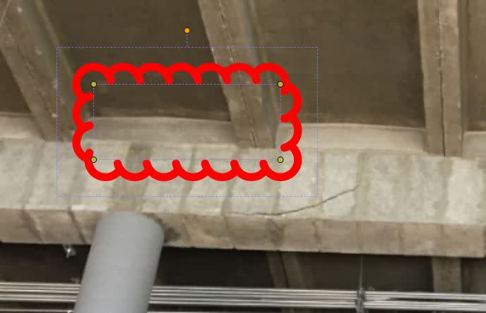

I'm looking for a second opinion on a repair detail for a cracked masonry beam I observed last week. In the pictures attached you can see an overall view of the beam and crack as well as some closer shots taken from a lift on the opposite side of the beam.
The structure is:
- precast roof spanning 25'
- the roof sits on what appear to be masonry beam spanning between columns (the cracked beam shown). The beam is 16" deep (nominal) x 12" wide (nominal) and ea course is 8".
- 12" dia concrete columns spaces at ≈19'-0" oc.
- crack is approximately 3' long and runs horizontal for about 2'-6" then curves up to vertical at a joint in the CMU.
From what I can find the structure is 1940s era but I don't know what has been done to is since then other than reroof. Upon inspecting it we were hoping to find a steel beam encased in the masonry as fireproofing. However I can't find any reasonable evidence there is a beam in there. I was able to pull a large chunk of the beam out with my hands and expose about 1/2 the thickness (no steel beam appeared to be grout filled).

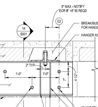

That being said we got some shoring out there ASAP just in case and now I'm looking to place a new steel beam under the cracked masonry beam to hold up the roof. She ain't pretty but I'm not sure what other options I have. I could potenial use a C15 on either side but the connection at the column makes me a little nervous because of the proximity to the top of the member (edge distance) and the fact the column is slightly wider than the beam.
In my detail I'm providing a steel collar to help provide confienment. Then through bolts to get loads into the column. Like I said - she ain't pretty but I thnk it'll do. Just wondering if anyone else here sees a potential issue with my scheme or has an easier way to do this.

- I'd be inclined not to jack unless the sag is producing some manner of undesirable serviceability issue. I worry that it does more harm than good in many cases. Some boats are best left un-rocked.
- I'd leave a gap between the steel beam and the masonry and fill that with grout intermittently or something along those lines.
- 12" round is not a big column. I worry that there'll be nothing left inside the collar but well confined dust when all is said and done. Could you hanger up as shown schematically below and make the column connection nominal?
- I like your C15 idea, especially if you can combine it with the hanger up concept. Perhaps you could install the top of the C15 flush with the top of the beam and bolt some hanger plates to the bottom intermittently that can be dialed in for a snug fit.

Thanks for the response KootK. There was some ponding on the roof but I'm not sure if that's a functions of the cracked beam or imporperly installed tapered insulation. That's why I was hoping to jack things back to normal. I could install the beam with a slight gap then have them wedge shims into the gap to "pre-load" my steel and relive the CMU beam.
As far as the hanger goes - I'll need to think on it more. I'd be hanging off of the precast planks that my steel beam are suppsoed to support. I sort of end up with a cirular load path. I was also hopping to avoid having to go through the roof to keep them from having to do any roof work until they reroof again. YOu could be on to something here - I'll just need to think through how I could make it happen.

Quote (T_Bat)
I was reading the clouded bit below as diaphragm that could be penetrated to do my nasty hanger business. Is that so? Tell me fast as I'm working up some sketches based on that. I see the actual "hanging" being from the cmu beam.

I've decided on going with scheme similar to what KootK showed. I've used back to back angles with a space for rods to make my hangers. Let me know if you guys see any major issues (attached).

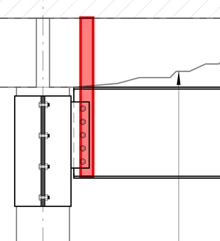

1) Are you fairly convinced that the crack extends through the full thickness of the member as opposed so just the face shell of the block? I ask because, given the construction and the rotation at the ends of the roof planks, I could totally see this being an application where the face shells are loaded directly. Imperfect bond between CMU and grout, a maybe a little prying action, and I could see things developing as they have.
2) I worry a bit about the connection shown below which will have to transfer the entire beam reaction. Are steel bearing or pull through issues at all? Are masonry bearing stresses going to be high with the force concentrated under the vertical legs of the angles? I freely admit that my paranoia probably stems from the fact that I don't actually know how to evaluate such a connection myself. Perhaps you can educate me a bit in that regard. I will grant that the connection is clever and preferable from a constructability perspective.

At least at this one connection. Maybe a plate washer on top of the angles would be nice.

I'm not 100% sure what you mean in point #1. The crack does not extend all the way through in the areas I could observe. A large chunk near the end of the crack at the top of the beam came off with some light prodding and it appears the grout was "intact" (i.e. smooth surface that appeared to match the profile of the block).
As far as #2 goes - For steel bearing on the bolts head - I'll be honest I didn't run the calc. I would look at the F dimensions (flat width) of the bolt head divided by 2 for the max bearing width. Then for each bearing length you would use the flat width again since it would be the minimum length in contact with the bolts. The product of those would give the bearing area per leg for one bolt. Then use EQN J7-1? If I do that, I'm definitely good but that still doesn't seem quite right to me. It may be a good idea to add a plate washer up there to mitigate pull through issues.

Ha! You beat me to it. Plate washer feels like a good idea.

Quote (T_bat)
I'm trying to ascertain if your crack is a shear crack:
1) Through the CMU AND the grout or;
2) Through the CMU but NOT the grout.
In my mind those are quite different problems.
RE: Cracked Masonry Beam Repair
Yeah, that looks like the real deal. Does it telegraph to the other side?

The crack occurs on both sides but I can't see if either is cracked all the way through. The cracks aren't exact mirror images but pretty much follow the same path. The side I have attached a picture of showed the worse side. I wasn't able to get the lift to the other side due to some cubicles and workers doing their thing.

One thing you may want to consider about the thru bolts is the constructability issues. How are they going to get a hole drilled perfectly straight to align with the hole in the opposite plate?
Are you going to field drill one of the plates from the backside with a long bit? Chemical anchors may be better for that reason.

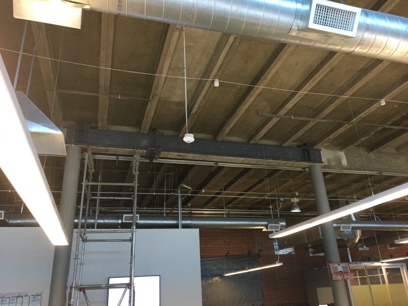

Quick update - the steel repair beam has been installed. I added plate washers to all the hanger (thanks for pointing that out KootK). Just wanted to send my gratitude to everyone who helped on this!
a) Most welcome.
b) Absolutely love seeing our ideas take form in real life. Thanks for reporting back on this.
