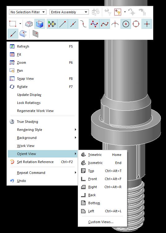

RE: nx11 replace views, where is it
Right click in the graphics area, it should be in the menu that pops up.
NX 11.0.1.11 Windows 10
Hi multicaduser
This is my right click
I see only separated orient views
and no separated replaced views
Thank you in advanced.
Please can you post your right click
popup

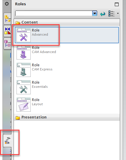

Select Advanced under Roles, and the missing command will be back smile
- Why / what are you using the replace view command ?
- The benefit in using "Orient View" instead of "Replace view" is that since Orient only rotates the view, all the view data is the same. - faster.
But if you replace the view, NX will re-generate the data for the view. - Slower.
Regards,
Tomas
