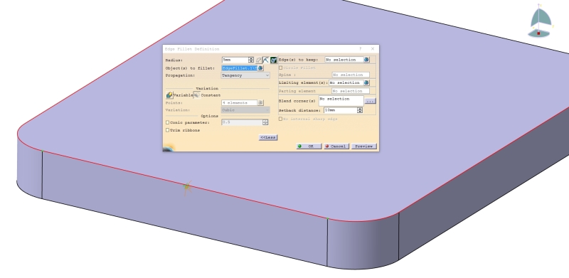

I am getting 2 different results on 2 different computers, both at V5R26.

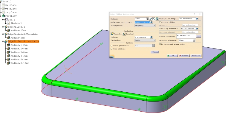

When I generate a variable EdgeFillet.3, and then go to modify it, all the radii values lay on top of each other.

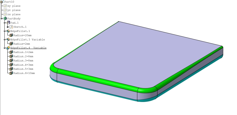

The tree shows only one value, and the points are de-highlighted in the window.
When someone else creates the EdgeFillet.4 I get what I would expect and seen in the past.
Has anyone seen this happen??

I cleared my catsettings and now it works as it should.
