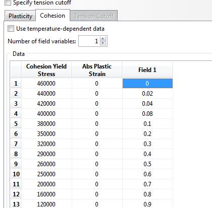

I want to change cohesion yield stress via PEEQ in mohr coulomb plasticity; Hence, I use USDFLD subroutine. but I don't know how remove abs plastic. I think abs plastic is different from PEEQ. so should I fill abs plasic strain with 0?? (like below picture)
