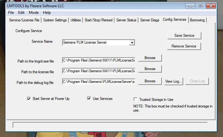

Something happened last Friday after cleaning my computer.
I get this message:
What did I do?
How could I fix this issue?
I am not good at IT......

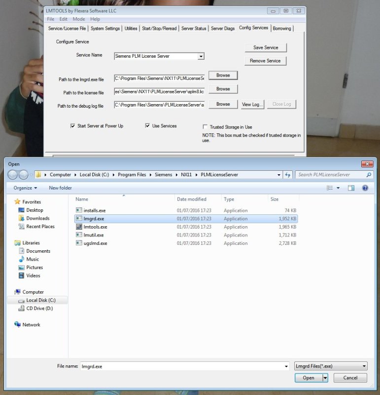

Where should I go (please, see the picture below)?
CAD 2015
RE: NX 9 license
For Ehaviv's instructions, try the Start/Stop/Reread tab. It should be obvious from there.

Based on the first screenshot, it looks like the SPLM_LICENSE_SERVER environment variable needs to be updated or recreated (it may have been removed when you uninstalled NX 10).
www.nxjournaling.com

choose config services tab
And check/set the correct license file
the one you need (nx9)
And then choose stop/start tab
And press start server.
RE: NX 9 license
go these steps
when ask respond YES
click stop server
click start server
RE: NX 9 license
Ehaviv,
Great directions, I got back my NX9!
