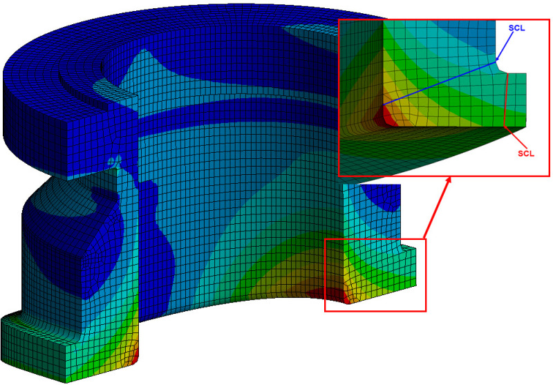

TGS4 please help me understand an issue regarding SCL's as per VIII-2 Part 5. In one of your previous posts you mentioned something that I have doubt if I got the point or not. It is in thread794-412084: PREX & TGS4 - Could you both please help with some Stress Linearization?

TGS4 What is meant by the meridional stress in the following:
Quote (ASME BPVC VIII-2 ANNEX 5-A)
Bending stresses are calculated only for the local hoop and meridional (normal) component stresses, and not for the local component stress parallel to the SCL or in-plane shear stress.
Does this mean the stress which is normal to the SCL and lies in the SCP?
Is it necessary to consider multiple SCL around the stress concentration region or just one will do?
Is there any guide regarding the orientation of the SCL? Are the following SCL's appropriate?
RE: SCL for ratcheting assessment
Meridional is also analogous to longitudinal. Both the hoop and meridional directions are generally mutually perpendicular, and generally mutually perpendicular to the through-thickness direction.
Regarding your SCLs - red, yes; blue - no.
The requirement of the Code is that the stress limits must be met "everywhere". You can use engineering judgement to reduce the number the SCLs, but you need substantial experience in order to be able to exercise that judgement.
As far as guidance goes, see WRC 429. We're working on additional guidance for the 2019 Edition. Might not make it, though... You'll get good guidance here.

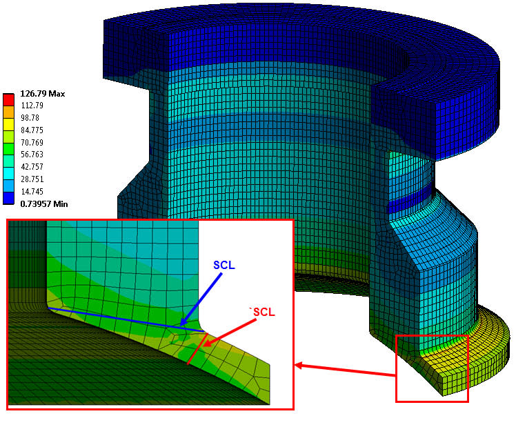

I have another nozzle which is on the shell (the previous one was on head).
For this nozzle two SCL's similar to the previous one are considered. here the blue SCL gives the Pm+Pb+Q to be 303 MPa and the red one is 185 MPa. Do I have to ignore the results of the blue SCL for this case or shall I take it into account because it seems to be more critical.
Second, I want to know that am I right for not categorizing stresses in elastic ratcheting analysis. Since secondary and primary stresses are to be considered, I used the FE results as such and linearize them to exclude peak stresses.
Is it OK to use tetrahedron mesh or do they have to be hexagonal?

Your blue SCL is still wrong. Especially for that geometry, try to have the SCL perpendicular to both the inside and outside surfaces.
I generally don't care about the element shape, so long as the results are independent of the mesh. You need to ensure that you have enough elements through thickness to develop a proper linearized distribution.
