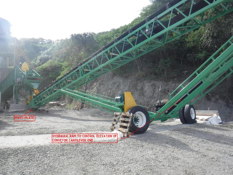

I was involved with the recent installation of a 36" (wide) x 100'+ (long) radial stacker for manufactured sand - and there was no counterweight, however it was a permanent installation, and the tail-end supported on a huge 5' x 6' base plate with a greased pivot plate.
Maybe temporary radial stackers use counterweights - I am not not sure.

RE: Radial Stacker
Quote (StrP88)
How is yours supported at middle and the cantilever part?
Permanent end-support via large pivot-plate, and 4-wheeled axle main support, with a free-cantilever, as follows:
Quote (StrP88)
I don't know in my case the counterweight is to provide dead load at the tail or for the belt to provide tension?
It is likely that the counterweight is for the tensioning-control of the conveyor belt.
