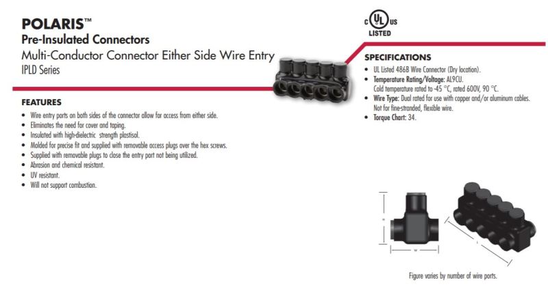

I'm a big fan of Polaris insulated connectors. They aren't the cheapest option, but they make for a clean install and you're already spending a lot on your conductors.
-JFPE

Thanks jfpe,
I'll have a few options now for my client. Eng-tips rules!

Thanks, crshears. In fact, I was asked to analyze that this evening as I left work. Buck/boost could be the way to go. I really like those Polaris connectors, too, though... It'll all boil down to $$.
