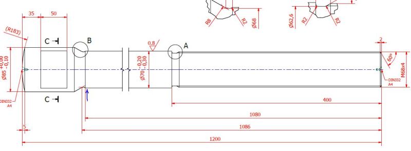

May sound like rookie question, but does someone have any idea or a better way to explain for double acting valve concept in terms of how it remains “locked and back-seated”?
Below photo is the remaining of spindle for 8”-Class 1500# high rate valve. In the event of overpressure, this valve should be opened (and backseated) from fully close position within 3 seconds
Aside from sulfide stress cracking contributing factor, I am wondering whether constant pulling load against back seat is also a factor. Or is the impact&pulling load is one time (fraction of seconds) only, after the positioner “see” valve is close, the hydraulic stop its attempt to move and pressure remains

Unclear 'what is what' in pictures but several factors might contribute. Most likely excessive forces over time. Could be wear, support/bearings too slim (to long and firm linked together parts giving skew loads), not correct adjusted or moved end-stops.
The stop impulse at 3 seconds will probably give greater stop forces on valve than a normal spindel is dimensioned for.

Support for actuator/piston. Loose link/fork between spindle top and cylinder piston to not give skew loads. Very precise adjustment of stroke.

not so good technical drawing, but the the first picture above is about about the spindle's link with the wedge. What we did at the moment is make the "shoulder" with radius and make sure the material heat treatment was correct and hardness was assured. It breaks on location indicated by the blue arrow. Due to time constraint of 3 days to fabricate new spindle, we were abruptly decide to minimize the stress by make it radius and the stronger the better (re-heat treatment the spindle) and measure its hardness

Looking at the fracture surface and drawing of the part where the failure point is noted, my first thought was bending fatigue failure. For one, the fracture surface is flat, which is consistent with bending fatigue. Also, you have a fairly rapid change in diameter where the fracture occurred (i.e., stress concentration). Any misalignment between the actuator and valve stem can cause bending stress on the shaft. If the valve is installed horizontal as is shown in the picture, it is highly likely that if anyone removed and reinstalled the actuator, there would be misalignment causing bending stress. The bending stress would be additive to the tensile and compressive stress every time the valve operates.

a) I believe that you could somewhat improve the performance by altering the spindle in addition to other improvements (support and non-stiff linking). Also have a new spindle ready to be changed as a prevention before normal breaking time.
Why is the spindle hardened, would a softer material be better? Other material (titanium)? Why is the spindle given a (weakening) grove, or do you mean a radius positive up from the shaft diameter and not down. In that case I agree.

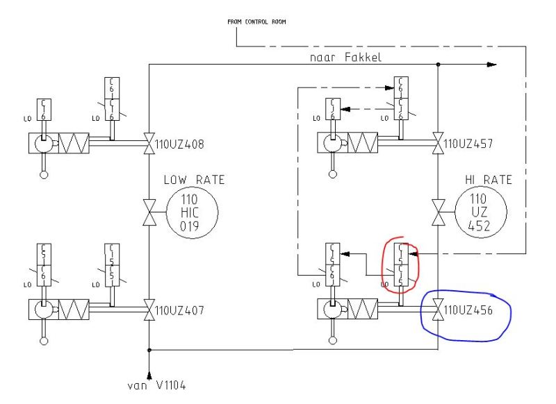

Subject of failure: spindle of 12”-1500# Gate valve (blue circle below)
General protocol:
If there is an indication shall vessel (V1104) will be over-pressurized>it will trigger the alarm>control room personnel push the button manually to open UZ456 and UZ457 (motion of operator from hearing the alarm to touch the button whether it is 5 seconds or 30 seconds is somehow bias)>the control valve in between, its function is to control how much excess pressure should be passed through the flare
Not clear: opening/closing time requirement
Measured and witnessed (by several accounts):
-Hydraulic actuator pressure 180 bar
-Opening/Closing time: 3-4 seconds (video is too big to be uploaded)
-Refer to 1990 drawing, stroke length of valve is 275 mm and stroke length of actuator is 290 mm. Opening’ stopper exceeds by 15 mm thus valve backseated??
-After control room personnel push the button, it took operation several minutes to hours before sending the operator using the stairs 110 m above to manually “lock” the 180 bar pressure within red circle compartment and preventing the valve from “accidentally” closed
-Commissioned 4 years ago, the opening/closing time was 12 seconds.
-Failed spindle is 17-4PH material with hardness 33HRC. Now we apply 17-4PH with 29HRC which is less prone for sulfide stress corrosion

Crack was initiated due to impact upon opening (and maybe also closing)>location of crack located in the narrowest and “sharp” area of the spindle>33HRC is more prone shall compared to 29HRC for sulfide corrosion cracking>again one more time valve opening> due to constant pulling force for xx minutes the stress crack grew bigger and spindle snap> closing the valve>one more time valve should be open, however now the wedge remains in close position due to already dis-engaged with the spindle
