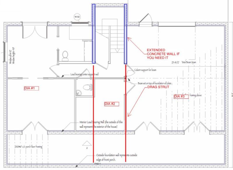

I have a 54'x34' residential basement with 9 ft. backfill on the front wall. The contractor will be backfilling with washed stone. I compute a load of 472 plf into the floor diaphragm. I don't normally like to go 54 ft. between shearwalls on a rectangular plan, but really do not want to get into interior shearwalls as the sustained loads end up being pretty high (near 500 plf). The stairweil is also interrupting my tension chord of the floor diaphragm. The foundation walls are precast concrete (Superior Walls). i never used to worry about things like this but am a little more risk averse in my old age. What would you guys do?

I recommend looking at the floor diaphragm as two, separate, three sided diaphragms, since the stairwell interrupts one of the chords.
DaveAtkins

The wall does span vertically, but the floor diaphragm needs shearwalls to resolve the load - either using the end walls only or with some interior shearwalls as well.

Why can't your porch floor brace the top of your wall against the rest of the building first floor? Looks like floor joists are oriented to help that also.

You should be able to tie it into the stair core and the endwalls... 54'x34' is a decent footprint.

They can for sure. I am concerned about the rest of the floor diaphragm being able to take the load.

Of course the second one will try to act like the first until those baby shear walls rock out of the way.
RE: Basement Wall Bracing

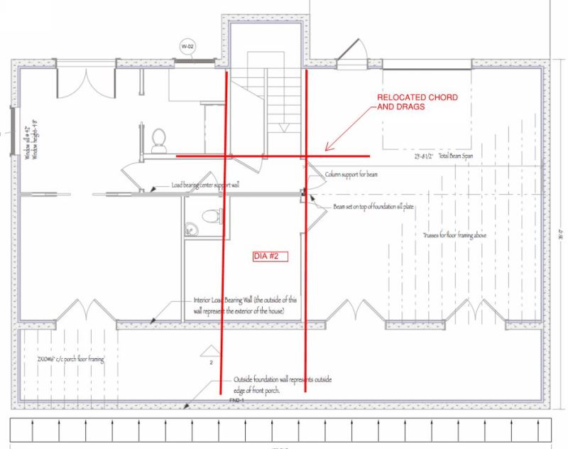

Thanks Kootk. Without the extensions, looks like I have about 6.6k going into to each wall over 5.5 ft. or about 1,100 plf. I'll see if I can get enough Simpson clips on the LVL!
If I go with the extensions, I may still have an uplift problem which would have to be resolved. I may have that problem without the extensions as well.
Might be better to use the wall to the left of the powder room for a single drag strut. Would not have an uplift problem and will be easier to connect to. That still does not solve the interruption of my diaphragm tension chord by the stairwell but i have never seen that be an issue in practice anyway.

My concern is failure of the floor diaphragm as its tension chord is interrupted by the stairs. I have 9 ft. of backfill along the entire front of this house and pre-cast foundation walls that do not provide any propped cantilever effect. Have I ever seen this be a problem in practice - no, but we all should worry about it maybe a little. As DaveAtkins stated I could try to count on two three sided diaphragms but i am concerned about the shear deflection under the sustained loads. I realize, in reality, the lateral stability of most building can be attributed to a series of three sided floor or roof diaphragms as it is not always possible or practical to have continuous diaphragm chords - but the sustained load cases are the ones that keep me up at night.

Why would you consider two three sided diaphragms? You have one diaphragm with an opening in it. You would design for the shear and moment based on the opening. If you need examples a book with a good number is "The analysis of irrgeular shaped structures" by Malone and Rice.
Hmm, there is an opening in it, but what about the disruption of the tension chord? What would take the moment?

The chord shown in KootK would be designed for the loading, and then collected back into the full diaphragm. You can try looking up diaphragms with intermediate offset.

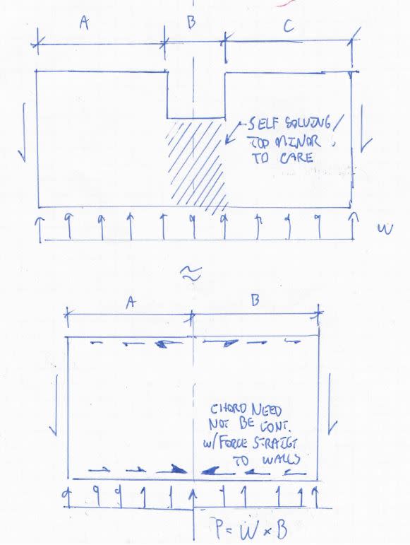

The situation changes in a significant way when your shear forces are delivered directly to shear walls rather than to "floating" chords: the chords no longer need to be continuous in order to do their jobs. And that's a very handy thing for your particular situation.
You can replace your real diaphragm with the hypothetical one below and proceed as usual, treating the diaphragm as simple spanning. If you're a stickler for precision, you can also give the sub-diaphragm in the middle some attention easily enough. I'd be inclined not to bother.
I also note that in most respects, this approach would produce the same results as DaveAtkins' double cantilever proposal. As such, I consider this approach to serve as validation for Dave's. Not that Dave needs me to validate his recommendations of course.
Screwed up my sketch a little. Should be A & C in the second one, not A & B.

ok, makes sense. thanks

I gave KootK a star for agreeing with my approachthumbsup2
Seriously though, my thinking is that if a chord is interrupted, the conventional wisdom is that the diaphragm will fail. However, it truly CANNOT fail, because in order for the diaphragm to tear apart on the tension edge, it would have to overturn the basement walls which are parallel to the tension chord. Which will not happen.

Sweet. Diplomacy has earned me a good deal more stars than technical expertise I reckon'. I agree with your latest 100%. Sadly though, you can only star me once per thread...
