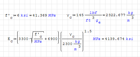

I'm doing some sheets in SMath Studio and am having some difficulty with units in some of the code equations. They produce a numeric value, but, the units are not consistent within the equation.
I'm currently adding another 'coefficient' that 'neutralises' the units within the equation and eliminates them, and providing a correct unit at the end of the equation for all parts.
Does anyone know of a simpler manner of overriding SMath units?

Rewrite the equations with a consistent set of units and convert the inputs as necessary.

For example, the formula direct from the CSA Standard (concrete code) is Ec = (3300*sqrt(f'c)+6900)*(γ.c/2300)^1.5
where f'c is MPa, gamma is kg/m^3, c is MPa, all raised to various powers... the result is MPa. I have to introduce coefficients that render the results dimensionless and then tack on a unit.

Yes, went through that thread... good post... and was my original solution... I was just hoping there would be an easier method. SMath, if you run your mouse cursor over the formula, yields the units, and it would be a matter of correcting for these.

More bulletproof way is to make f'c and γ.c dimensionless using division by MPa and kg/m^3. It will allow to use US or SI units for definitions. Please see attached.
