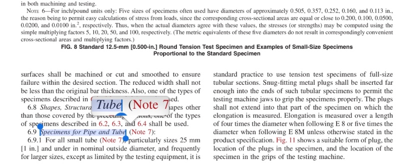

Dear colleagues,
I am performing some analysis on seamless tube of alloy 800. During tensile test at 350°C I have found that the tube, in all the cases, break forming a spiral crack.
At room temperature, the material break in a standard way (forming a neck). In both cases the fracture surface shows ductility.
I tried on different testing machines and different rates and the behavior is the same.
The material tested was previoully annealed at 980°C.
Could someone explain this phenomenon?
I have attached two pictures to better understanding.
Thank you

During the test bands of Lüders are formed, favored by the temperature, this process is sensitive to the magnitude of the generated stress, which is why the behavior changes when modifying the size.
The inclined fracture follows the orientation of the bands.
Maybe if you do a test with the polished tube you can observe these bands and confirm the phenomenon.
Another probability is formation of slip bands and/or twins, at the end same behavior.

Thanks everyone for your usefull comments
Alloy 800 is an fully austenitic alloy stabilized with Ti. Similar to an asutenitic stainless steel but with higher content of nickel and chromium. (UNS N08800).
I agree with MarriolaV that this phenomenon could be related with Luder bands formation. Sometimes, lines with an angle of approx 60° can be see it a both sides of the fracture.
What is not clear for me yet is the effect of D/t ratio on formation of that slip bands.
So far I have not found any standard (ASTM , ASME, ISO, etc.) that considers this effect and the problem our client wants the tube to be tested in full size.

Isoca
ASTM E8 and E21 could be useful. I’m general ASTM methods are intended to use test pieces whit geometries where the stress distribution be good enough in the calibrated section..
Are you using correct length of test piece?
And remember avoid over press de tube whit the grip and internal support.
RE: Spiral crack on Alloy 800 tube under tensile test
I have tried with different probe configuration, always inside of ASTM E8 and E21 and the results remain the same. i have found some articles that relate this crack morphology with the OD / WT ratio. For example in aluminum tubes some authors indicate that if the ratio is grater than 20:1 the fracture is of spiral type. In this tube the ratio is 19:1.
In order to verify this situation I have tried with stainless steel tubes with ratios greater than 20 and in all cases the fracture has an anlgle of approx 60°. No spiral was produced but..
These SS tubes broke in a standard way (forming a necking in a middle) when tested at room temperature.
